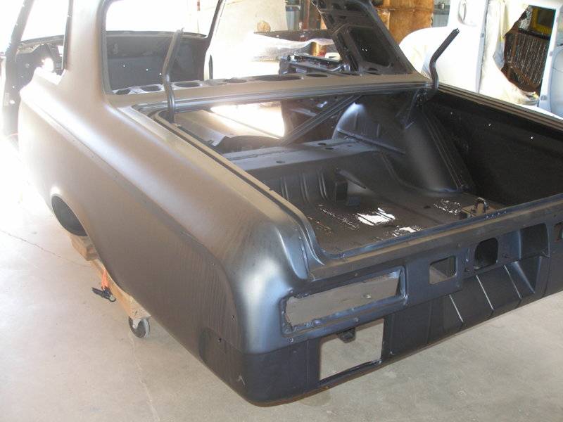

I had my 63 Polara Max Wedge Clone in an auto body shop for 6 years, cost of $6,500 total loss with lost parts.
I pulled the car out, took it to Pacific Powder Coating, Palmdale CA for Soda Blast of the car
1. Excellent job, stripped to bare metal
2. NO Residue, and if there was, I would have GLADLY vacuumed it out...
3. They "E-coated" it for me
4. Cost? $1,400 total
And yes, I was thoroughly pleased as it was completed in 2 days.

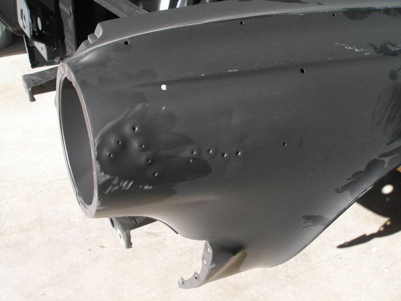

Yup, that is what I did, Trunk Floor pan was rusted, good ol' AMD trunk pan...BUT, after we media blasted (Soda Blasted at Pacific Powder coating) eldubb440...THAT is when I found the passenger front floor pan that you mentioned...along with the damaged left front fender...
ALL Hidden by the first paint shop...

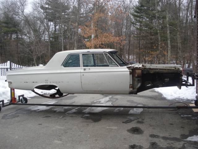

Got it....it does not look too bad...?
Show some more pics...
