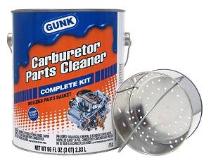

Years ago, mid 60's, they sold a carb cleaner with a metal case were you could put the carb in after you took it apart and now could do a good job cleaning. I don't remember the name or any other details but it was a great product in its day. I do remember it had a basket so after cleaning, lift it up and cleaner would drain.

Has anyone tried the GUNK carb cleaner in a big *** can lately?
That stuff used to be the mac daddy. Wonder if the EPA got to them, too?
Yes, I have a can of that and the berryman. Both do just fine I think, and I've rebuilt some nasty carbs lately. I also usually let the pieces soak over night, clean with an old toothbrush and compressed air ...
