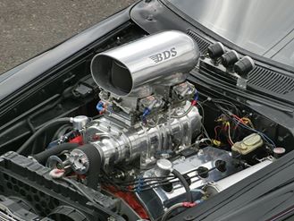

I don't use power valves
I have no power valves and run 90 jets 4x it runs a tad rich but, very close. When I got this car it had 96 and 95 jets and both power valves. All this made a big change. Made and 11 second car into 10.8 10.7 consistently.
Race cars verses street cars: Different animals and WAY different tune-ups.
