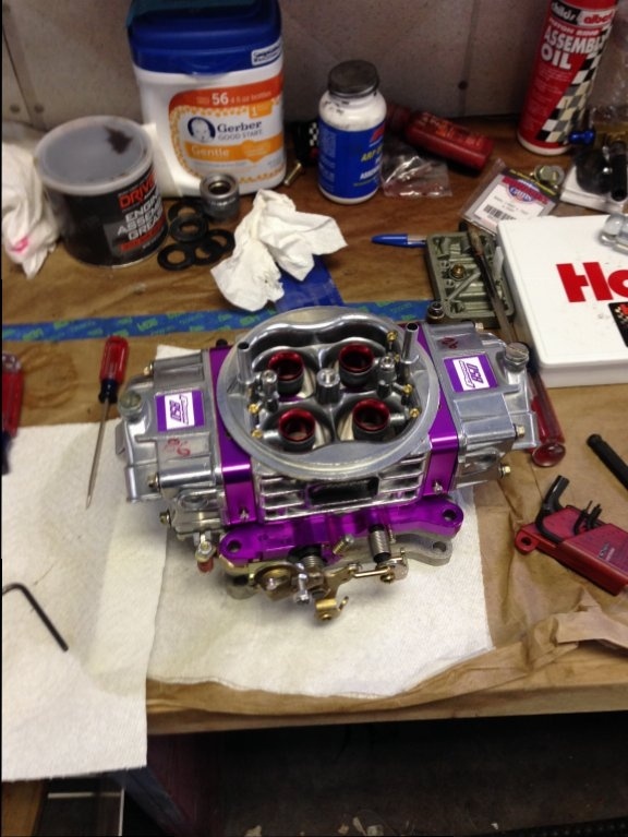

A good ole 850dp with the 1.56 Venturi would surely do the job. A 950 proform, or new hp carb would work well. I built a 1050an carb from a 850 street series proform a few months back. Runs real well on my 511, I had to dial back the amount of fuel it was getting through the transfer slots. Once I got that right it Runs exceptionally clean and gets good mileage for being a big carb.
