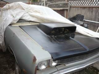

The Super bee in waiting.

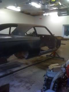

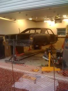

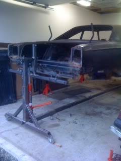

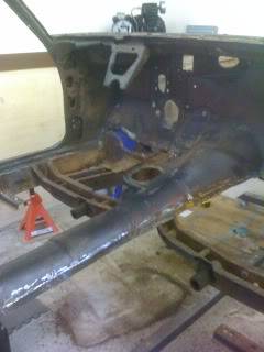

I am also help a friend restore his 69 Roadrunner 383 4spd post car. He bought the car with the best of intentions but had no tools no shop and absolutely no experience what so ever working on a car. so let the lessons begin. First he had a shop built then he bought a bunch of tools and a rotisserie. He bought the car when the market was high and got taken as I did with my 500 and is in very rough shape buy oh well you know what they say " Life wouldn't be fun with out a challenge ". He did not touch the car for two years because he didn't know where to start and was about to sell the car until I offered to help him as much as I could until it was completed. I just have a couple of phone pics handy at the moment of the car after we put it on the rotisserie.
We now have the car set up in a booth and I have my sand blaster there and I have him media blasting with aluminum oxide which I just happen to get six 55 gal drums of for free and has only been used once to blast new metal. I will keep you guys posted as I get some pics.

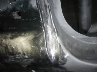

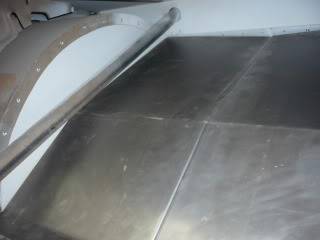

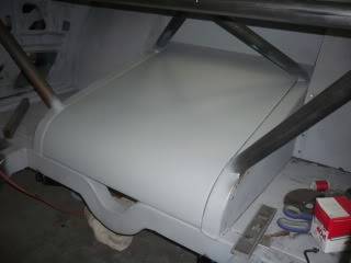

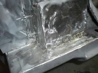

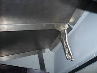

A little more tin work.

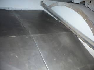

I had to do these in two pieces, need to trim the bottom yet and rivet them in after I do some more priming in this area.

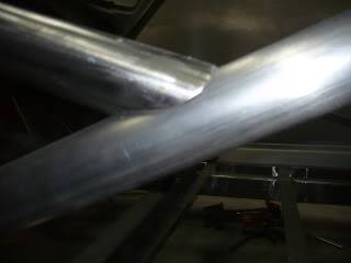

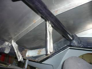

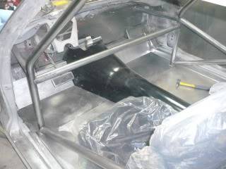

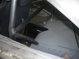

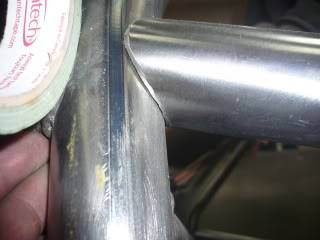

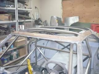

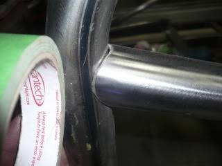

A few pics of the cage bars, I did all these joints with a grinder and zip blades. Very time consuming but the joints turned out really nice.
Damn buddy thats alot of work you've done there,lookin killer, I wouldn't mind having a pro-street b body, check mine out when you get a chance. Keep up the good work and the pics coming love the way it looks with the new rear tires.Think I can borrow that 493 from you.(lol) just kidding, engine looks real nice keep up the good work

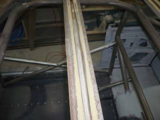

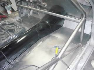

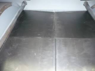

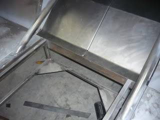

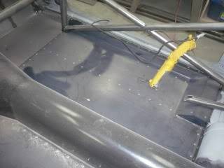

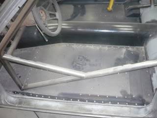

I got the floor pans and tunnel made and welded the tunnel and the front pans in but just riveting the main floor pans in and have them seam sealed.

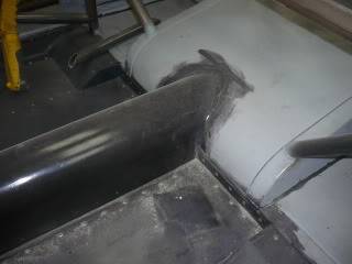

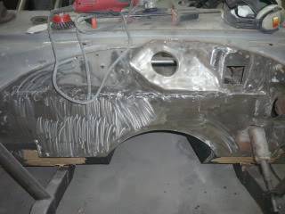

Got the fire wall almost done except for where the steering column comes through and just doing a little filler on the bottom before I spray DP 90.

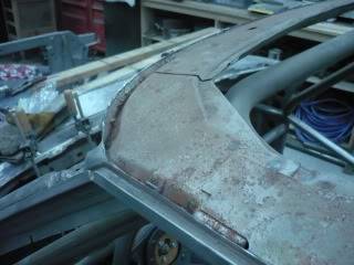

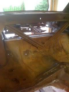

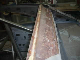

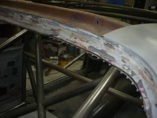

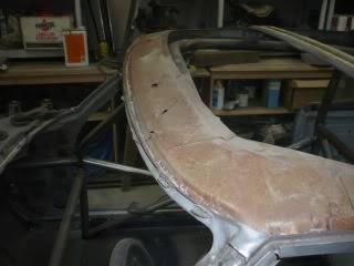

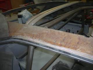

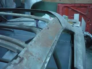

I am in the process of taking off the roof skin due to having vinyl roof rot. The structure under neath has some flash rust but is really nice and a lot of areas you can see new metal but hard to see in the pics.

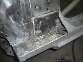

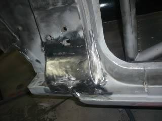

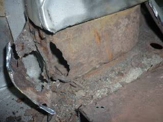

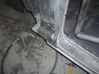

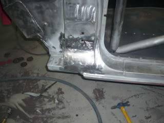

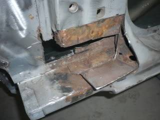

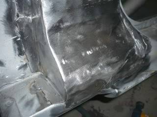

Did a repair on the lower driver side structure behind where the rear leg of the fender is. It was rotted out on the inside so I had to repair inside and outside of the structure.

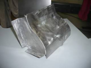

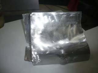

Made this piece for the outside structure.
