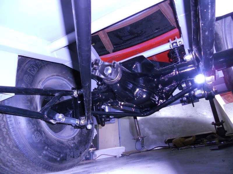

This pic shows the diagonal link which is now an X-brace for superior strength for street driving purposes.
Finished the the new brackets for the x-brace and the spacers for either side of the hiems that go inside the brackets. Made these brackets out 1/4" steel just for the extra strength.

I got the x-brace in and then checked everything again for square from front to back including all the panels and checked heights of the frame and all the panels and all is good except for the rear end housing, just have to move it 3/8" to the passenger side. Squared my check lines from the center line of the chassis same as I did from the start and used a laser set on these lines and took measurements all over the car and wheels. Took a few pics but doubt you can get an idea of the ride height from these angles. Over all I am happy with things. Now I just have to get the cage welding completed, motor plate mounts made and welded in, engine limiter braces made, last piece to the tranny mount, rad mount and the trunk hinges completed (75% complete ), make new motor plate, get a different oil pan ( need to lower the engine a little bit ), then I can finish a little bit of sheet metal then body work can start then paint. As usual there is always a few details that need to be done along the way but at least the hard part of fab work is complete.
