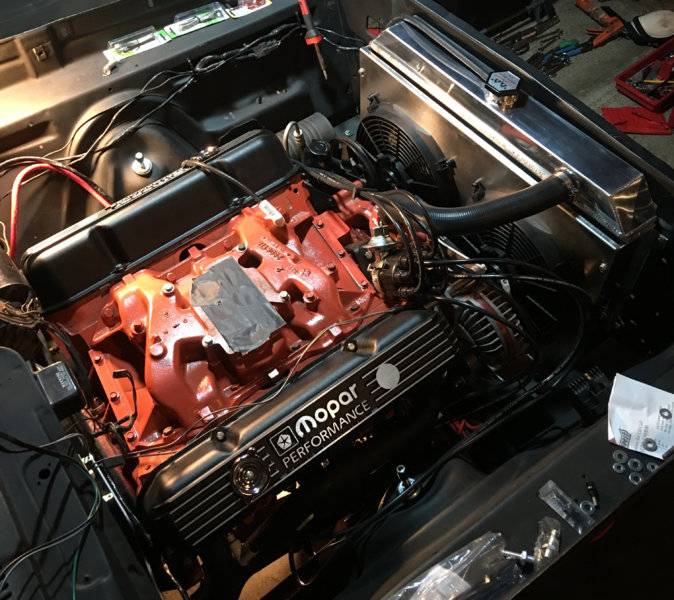

I ran the double fan system with a 4 core Champion Radiator, you can see it run in the video below. When they kicked on it sounded kinda cool.
(The flex fans from what I read require more HP from the engine. If you use a mechanical fan, a clutch fan uses the least amount of HP.)
1968 Charger 440:
Also in the video at 33 seconds, you can see the Relay Switches for the fans mounted where the battery would be. I'm going to build a water proof box for them.
