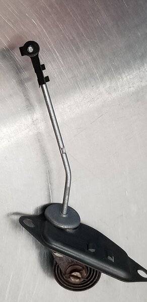

Anyone have a line on the choke stat gasket for the big block 64 intake manifold? I have 4 NOS 340 style, same bolt pattern but too wide. Thanks!
Choke stat...I need the mounting gasket that goes between it and the manifold.
Ok, so unlike the 72 340 no gasket..thanks!
You know after 60 years you lose a few things...one of which is memory...Thanks for jogging it!
I had one of those divorced chokes on my 318 poly with a 2 barrel. It didn't work at all. I replaced it with an electric choke and it works 1000% better.
I'll bet the exhaust passage in your intake manifold is plugged with carbon.
