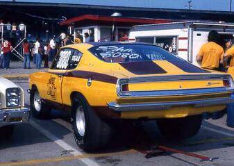

He painted this 1968 Hurst Hemi 68 Barracuda Factory 426 Hemi super stock car. worth around $700K. Original owner & Campaigned by Jerry Dailey

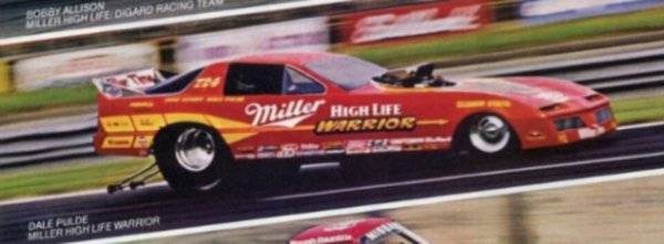

He was Painter & Bodyman for Dale Pulde's Miller High Life Warrior funny car
