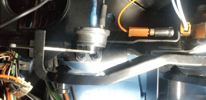

If you don't care about original but just want a functioning clutch switch, I used this:
https://www.amazon.com/gp/product/B003C01FFY
I made a small bracket to mount it and it works great and for a lot cheaper than an OE part
