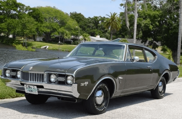

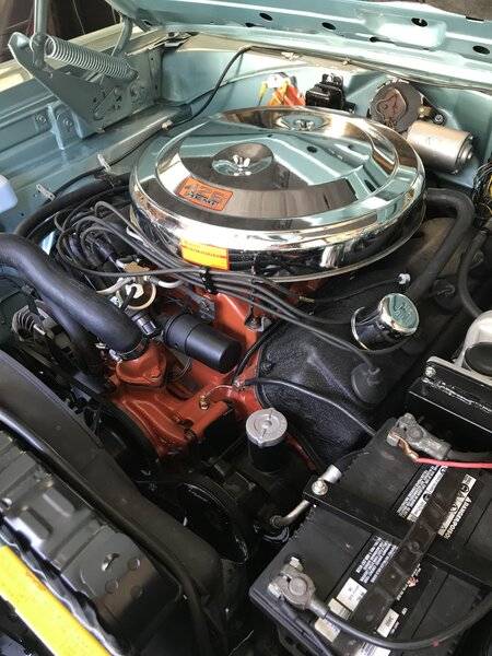

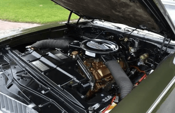

I have always liked the 1968 W31 ram air. Simple and understated.

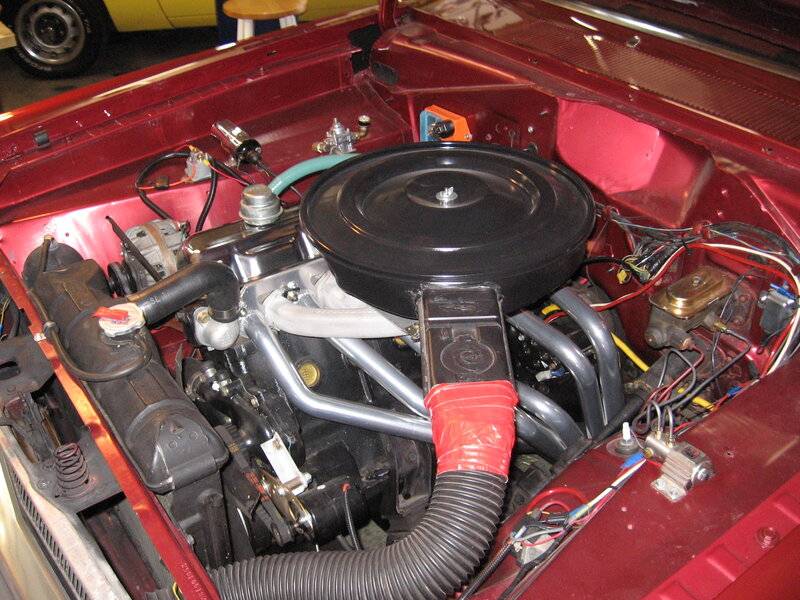

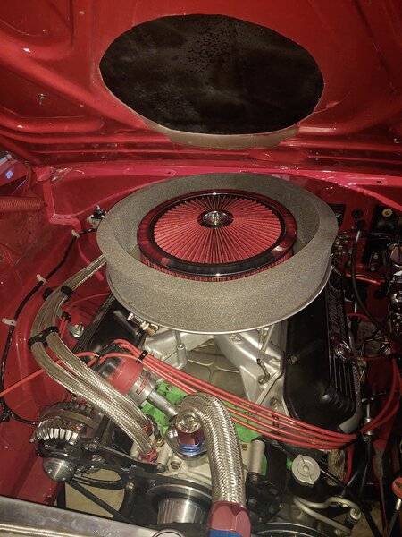

Laugh if you will but it worked for me.
Picked up almost a full 10th. Cost was $10 bucks.
Picked up almost a full 10th. Cost was $10 bucks.View attachment 1070247
Headlight bucket?
I assume the Grille, above it and below it, are high pressure areas. When a guy hits 90 mph, there is probably more pressure than one would guess. Nice, cool air for sure.

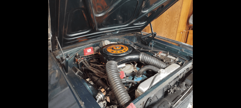

Wish the factory would have optioned this for the Hemi.

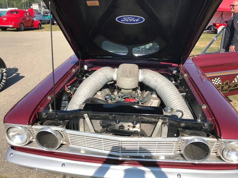

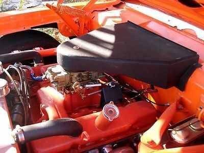

My friends Thunderbolt has a simple and very effective CAI.

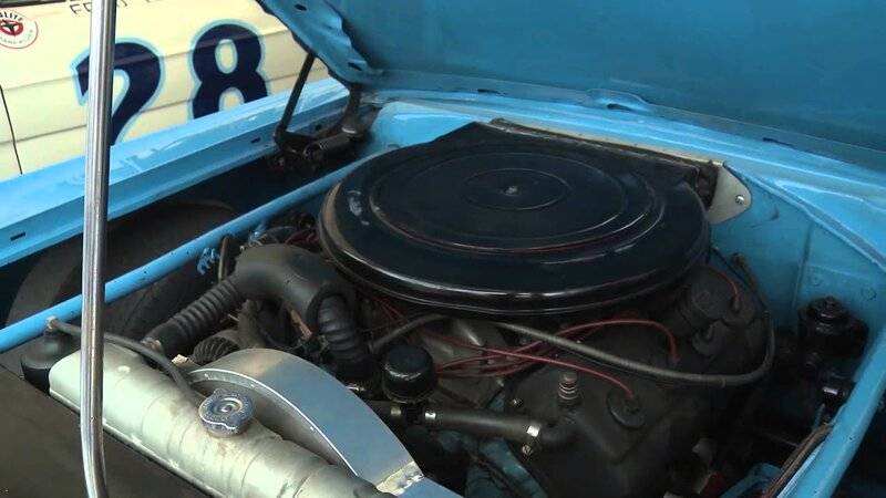

The top picture was for NASCAR. Mine is the middle.

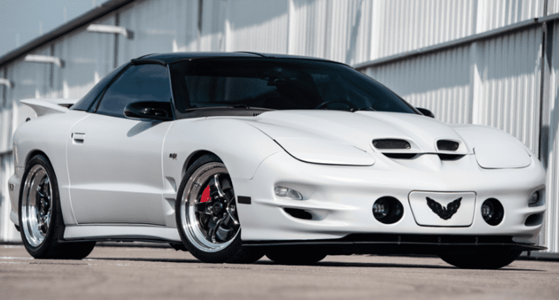

Pontiac claimed 15 hp gain over regular TA's with this WS6 scoop.

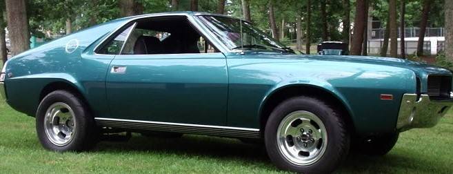

my AMX loved it, but the carbs would ice up in the right conditions........ under 45 degrees with high humidity meant guaranteed snow cones

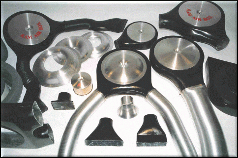

I found this place.
https://ramairbox.com/models.html
Part #10x3S
Height; 3", O.D. 12", Tube size; 4", Fits filter; #10x3 K&N, Stud to tip of intake; 10", Material; Fiberglass, Bottom Hole; 8" round, Top Hole; 14" round.
Part #14HS
Height 3" & up, Inlet size; 17" round, O.D. 21", Max Width; 21", Fits filter #AF3-4-5, Filter Size 14"x3,4,5" Stud to tip of intake; 10.5", Material; Fibreglass, Bottom Hole; 12" round, Top Hole; 17" round.
Part #14x3@80
Height; 3", Tube size; 4", Tube O.D. 17", Max Width; 21", Fits filter #AF3, Material; Fibreglass, Base Hole; 12" round, Top Hole; 14" round.
Part #14x3@110
Height; 3", Tube size; 4", O.D. 17", Max Width; 25", Fits filter #AF3, Stud to tip of intake;13", Material; Fibreglass, Base Hole; 12" round, Top Hole; 14" round.
Part #14x3C
Height: 3", O.D. : 17", Max width: 17", Fits filter : # AF3 Stud to tip of intake: 23", Material : Fiberglass, Bottom Hole: 12" round, Top Hole: 14" round.
Part #14x3S
Height: 3", O.D. : 17" Tube size: 6" , Max width: 17", Fits filter : #AF3, Stud to tip of intake: 14", Material : Fiberglass, Bottom Hole: 12" round, Top Hole: 14" round.
Part #14x3SC
Height; 3", Tube size; 17"x 3" rectangular, O.D. 17", Max Width; 17", Fits filter #AF3, Stud to tip of intake; 10", Filter Size; 14"x 3" round, Material; Fibreglass, Base Hole; 12" round, Top Hole; 14" round,
Part #14x3ST
Height: 3", O.D. : 14", Tube size: 4" , Max width: 17", Fits filter : #AF3, Stud to tip of intake: 10", Material : Fiberglass, Attaches directly to 14x3 air filter.
Part#14x4@80
Height; 4", Tube size; 4" tube, O.D. 17", Max Width; 21", Fits filter # AF4, Filter Size; 14"x 4" round, Stud to tip of intake: 13", Material; Fibreglass, Base Hole; 12" round, Top Hole, 14" round.
Part #14x4@110
Height; 4", Tube size ; 4" tube, O.D. 17", Max Width; 25", Fits filter # AF4, Filter Size; 14"x 4" round, Stud to tip of intake: 13", Material; Fibreglass, Base Hole; 12" round, Top Hole; 14" round.
Part #14x4S
Height; 4", Tube size; 4" tube, O.D. 17", Max Width; 17", Fits filter # AF4, Material; Fibreglass, Stud to tip of intake: 14", Base Hole; 12" round, Top Hole; 14" round,
Part #14x4SC
Height; 4", Inlet size; 4", O.D. 14", Max Width; 17", Fits filter # AF4, Stud to tip of intake: 10", Material; Fibreglass, Base Hole; 12" round, Top Hole; 14" round,
Part #14x4WC
Height; 4", Inlet size; 4", O.D. 16", Max Width; 17", Fits filter # AF4, Stud to tip of intake; 10", Material; Fibreglass, Base Hole; 12" round, Top Hole; 14" round,
Part #14x5@80
Height; 5", Inlet size; 5", O.D. 18", Max Width; 22", Fits filter # AF5, Stud to tip of intake: 13", Material; Fibreglass, Base Hole; 12" round, Top Hole; 14" round,
Part #14x5@110
Height; 5", Inlet size; 5", O.D. 17", Max Width; 26", Fits filter # AF5, Stud to tip of intake: 13", Material; Fibreglass, Base Hole; 12" round, Top Hole; 14" round.
Part #16x4@95
Height; 4", Inlet size; 3", O.D. 18", Max Width; 25", Fits filter # 16x4 K&N, Stud to tip of intake: 13", Material; Fibreglass, Base Hole; 14" round, Top Hole; 16" round.
Part #16x4HD
Height: 4", O.D. : 18" Inlet size: 6" , ( oval 4.5" x 7.5" ) Max width: 18", Fits filter : #16x4 K&N; Stud to tip of intake: 16", Material : Fiberglass Bottom Hole: 14" round, Top Hole: 16" round.
Part #21x10x3
Height; 21"x10" oval, Inlet size; 5", O.D. 13", Max Width; 25.5", Fits filter # K&N-21x10, Stud to tip of intake: 14", Material; Fibreglass, Base Hole; 19" x 8" oval, Top Hole; 21" x 10" oval.
Do you need a custom kit? Please inquire at (905) 549-6135
