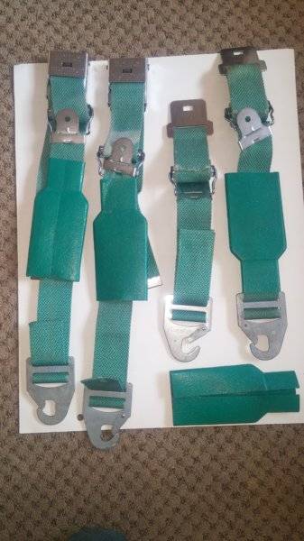

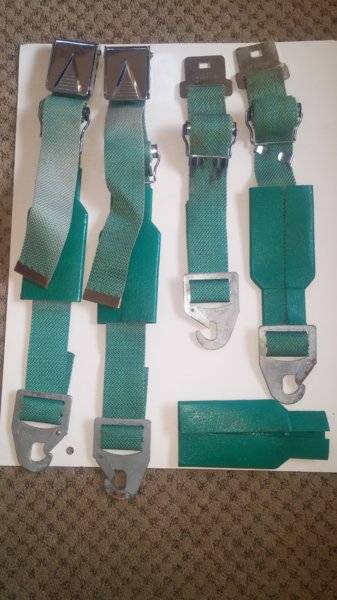

I'm going to try to restore the original belts from my '63. Has anyone done any color dying to these, or know someone that does this ? I remember many years ago, seeing RID Dyes for sale in stores, or markets. I should also add, that I would be interested if anyone had a Very Nice set available, in this Turquoise color. Any and All info appreciated, Thanks...
View attachment 940058 View attachment 940060I'm going to try to restore the original belts from my '63. Has anyone done any color dying to these, or know someone that does this ? I remember many years ago, seeing RID Dyes for sale in stores, or markets. I should also add, that I would be interested if anyone had a Very Nice set available, in this Turquoise color. Any and All info appreciated, Thanks...

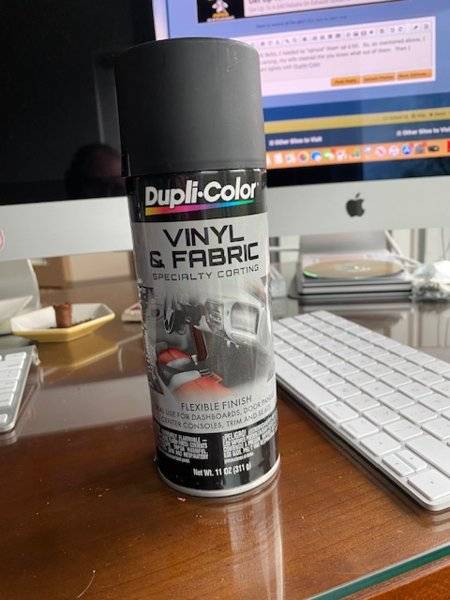

On my Black Belts, I needed to "spruce" them up a bit. So, as mentioned above, I cleaned, no wrong, my wife cleaned the you know what out of them. Then I sprayed them lightly with Duple-Color Vinyl and Fabric Speciality Coating. I use the HVP106, Flat Black for my belts and other interior parts. Dupli-Color has some interesting videos on their site about the product, if you are interested. Here is the Can.
I do not know if they have it in that color, but you might check. If it works for Seats, it might just work for the seat belts. Good luck. B.
