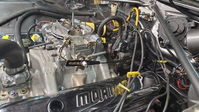

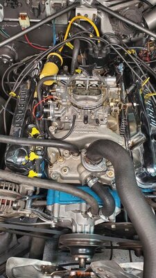

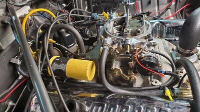

So to start off I have a 73 Charger 318 w/ w30 heads, 262 comp cam. Edlebrock 4bbl performer 318/360 intake w a carter afb 9636sa. I've been playing with this for over 10 years and put maybe 20 miles on it in 8 years. It has had a issue where tap the key starts up sounds great. Tap throttle and it kicks down and dies. If I get the car to idol on its own when I put it into gear it slams. Then I'm fine until I come to a stop and car dies. I can always get the car going but not reliable enough to take wife in it or her drive it. With no emission pieces and the fact that every picture I look at on the web has someone using different intake port or they have their carb hooked to pcv valve, some have booster connecterd to carb some to intake. Im just curious what jumps out at others as to the issues I'm having. I spend hours standing next to it searching the web and then my brain turns to mush. Thoughts are great im not a mechanic but have always worked on my cars but this that should be the most basic kills me...

Man I wish you were close to me, I'd help you out in a heartbeat.... right off the bat it sounds like a carb issue. Check float level, idle mixture. Make sure no vacuum leaks, all ports used or plugged? After you get it to idle verify timing.
I'd guess you're dealing with vacuum leak(s). A couple things I think I make out on your pictures:
The PCV valve hookup port is the one centered in the front of the carburetor. I don't know what you hooked it up to. Center photo shows something hooked to the rear intake manifold port which is normally used for power brakes and other vacuum needs such as under dash heater and a/c controls.
Is the PCV valve new? I've seen a bad one drive me crazy trying to figure out why the car won't idle down.
The vacuum advance for the distributor needs to be hooked up to a ported vacuum port on the front of the carburetor. Sorry I can't recall which is which off the top of my head, but you can look that up on line. If you have the advance hooked to a manifold vacuum port, you'll have full advance at idle but little to no vacuum signal off idle.
I would try all that as well as disconnecting the vacuum advance line, plug the port and see what you have for initial timing with just the distributor mechanical advance working. If the timing is too retarded, the engine will probably start up ok but won't like to idle down very well.
Once you have the car moving does the engine seem to run ok? Does it feel sluggish for example?
It slams when putting the transmission in gear; is the engine idling quite high at that point?
I'm sure others much smarter than me will chime in too.
One last comment: please re-do the carb return spring. That one looks way too stretched out and you should have a 2 spring setup for safety.
Edelbrock has their carb manuals on line if you need one for reference. Don't worry about how others set it up.
You are using the right port for timing, but the front middle large port needs to have the plug removed and connect it to the PVC (which should be on the valve cover but is missing in the photo). Keep the brakes ported off the intake like it appears to be. Set idle and check/set timing.
Report back.

Speaking of fires... I would remove that glass bowl filter from sitting on the intake. Many cars have caught fire just from that alone... There are O Rings in there that dry out and then loosens that glass tube which sprays fuel all over creating a massive fire... Not to mention that is a boiling point for gas laying there which creates vapor lock issues. Also the rubber gas line that long is not good either.. Good luck with the other stuff.
Ok so I've replaced fuel filter and raised it so no longer in contact with intake. used as much metal gas line as I had till I can grab new stuff, ya it was the points I was looking. I am using the Haynes book. so the new rotor is pointed to cylinde 1, i double checked wire location, all is good there. I've wondered which is better manual electric fuel pump. Alot of things will be done later I just wanna get it going! Trying to keep up and take the advice given. Which I appreciate.
