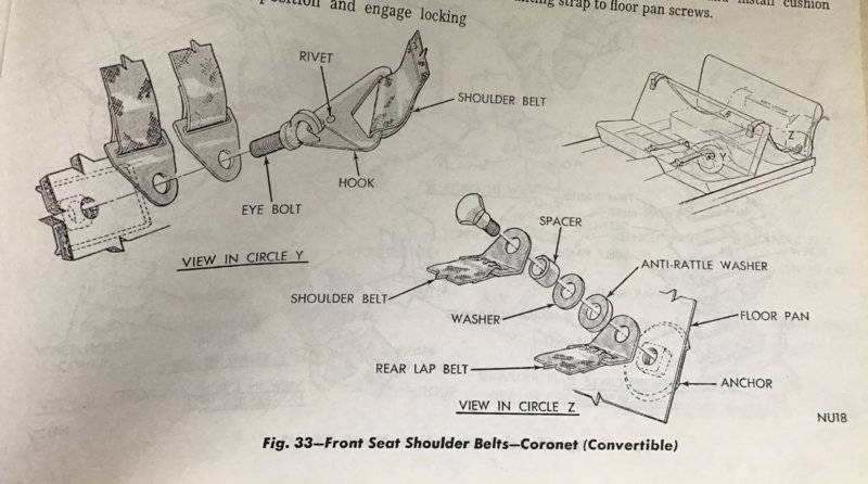

Perhaps for center passenger on a bench seat or buddy seat.
From 69 Dodge FSM showing Coronet install

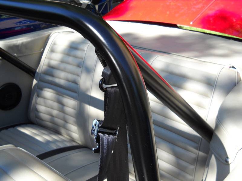

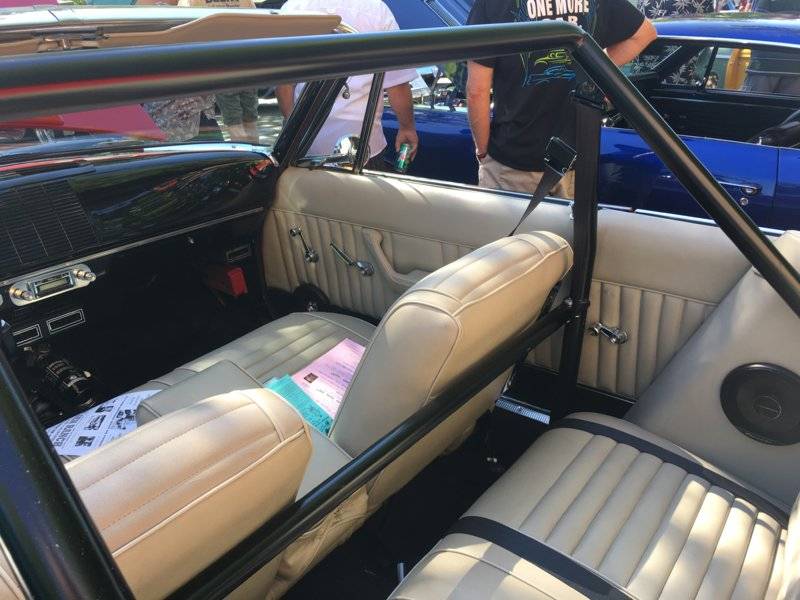

Probably a little more than you'd want to do but it was a solution for me. And yes, I always wear a crash helmet when I drive my car...
Your picture explains it clearly. I don't think they would be comfortable, especially for taller people up front. Looks like the belt coming from the back seat would cut into the neck and shoulder. I like Coloradodave's setup. Double safety with the roll bar and 3 point belt. @coloradodave Are your rollbars custom made?

Purchased from ChassisWorks without rear bars welded on. Added straight rear bars as it's a convertible.
https://www.cachassisworks.com/c-1674-roll-bars-roll-cages.aspx

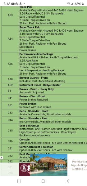

I almost bought a 1969 Barracuda convertible with the factory shoulder seat belt option about 5 years ago. Seat belts were missing, but fender tag had correct code for the shoulder seat belts. Which brings up my question; What is the option code for factory shoulder seat belts on a 1970 Coronet 500 convertible?
Probably a little more than you'd want to do but it was a solution for me. And yes, I always wear a crash helmet when I drive my car...View attachment 910672 View attachment 910674 View attachment 910675
Kudos on the helmet wearing, but without a proper headrest, it really also increases the chance of breaking your neck in a shunt. Neat car BTW.
