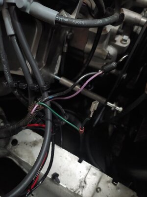

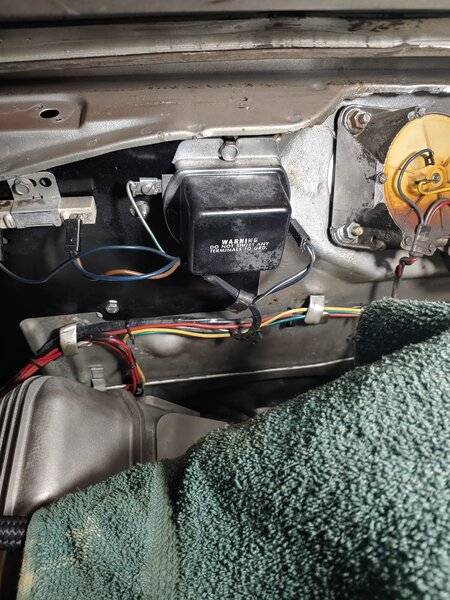

Yes I have those instructions but alitte confused about which wire I could use for sense and 12v switched. Or do I need to forget about the wires I posted and run new ones

12 volts switched source is the blue wire attached to the old mech regulator. That comes from Ign1 circuit. The green wire won't be used anymore... except if you want to splice them together to reach the alt instead keep a blue wire from end to end to reach the alt
I'm not really sure about what exactly that alt is requesting to make it work. Usually the switched source uses to be also the sensing wire. But there are several variations for that setup, like using a diff sensing wire from the IGN signal. The logic says for the sensing wire get it close to the batt, but if wiring is not in good conditions the sensing wire location could be tricky and get less or more voltage than the range needed for a safe alt sourcing.
Then also, as I told you on the PM, are you planning to keep amm? No need to remove it or bypass it with a straight wire between alt and batt/starter relay stud. Just take care of bulkhead conditions, ammeter conditions and couple of wire path upgrades between amm and the rest of charging system. AND SOURCE EVERY NEW ACC ADDED FROM GHE RIGHT POWER BUSS/SPOT/JUNCTION. With ammeters is simply WRONG source anything from batt!

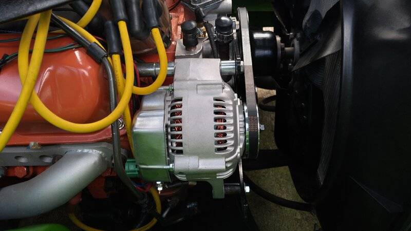

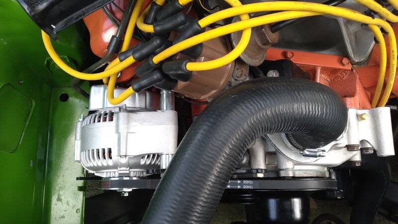

I tried one of these successfully thus far. A few shims, inch or two shorter belt and a metric bolt and it's on. Its for a 90's 4Runner. 70amp and $80 on ebay but the spec sheet is showing just under 40amps at idle. I may try a 120 amp but trying to get info on the spec sheet from the seller first for the amp output at idle (both internally reg). If I can get 50ish at idle I'll be happy as I have no real accessories other than heater and stereo with a small amplifier but may add things in the future. I do have my ammeter bypassed and a relay set up for the head lamps is in the near future also. You will need to get a 3 wire plug for this alt also. No splicing just changing a couple ends to fit into it at most IIRC. It's a bit smaller and different looking but looks clean and is roomy. I like it so far. Comes with the pulley you see. I've added another shim or two to make it line up perfectly and it's pretty solid.

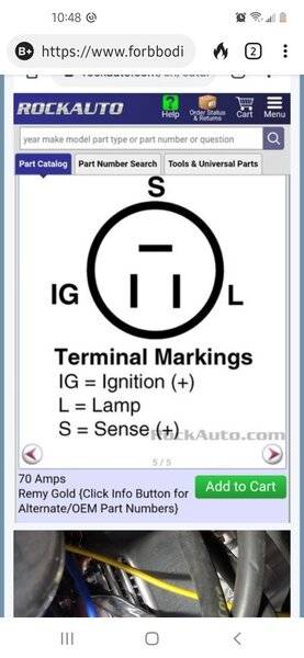

Lamp isn't used, sense (trigger, from 12v source), switched ign. source and then your usual output from alt.
