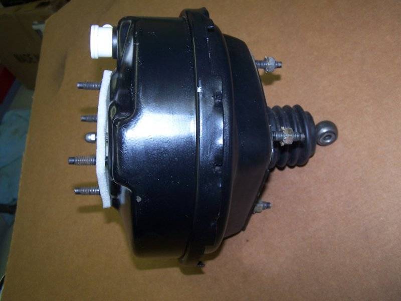

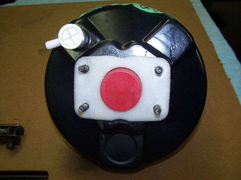

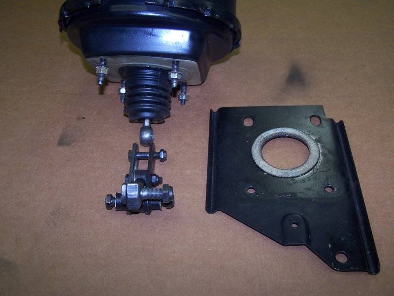

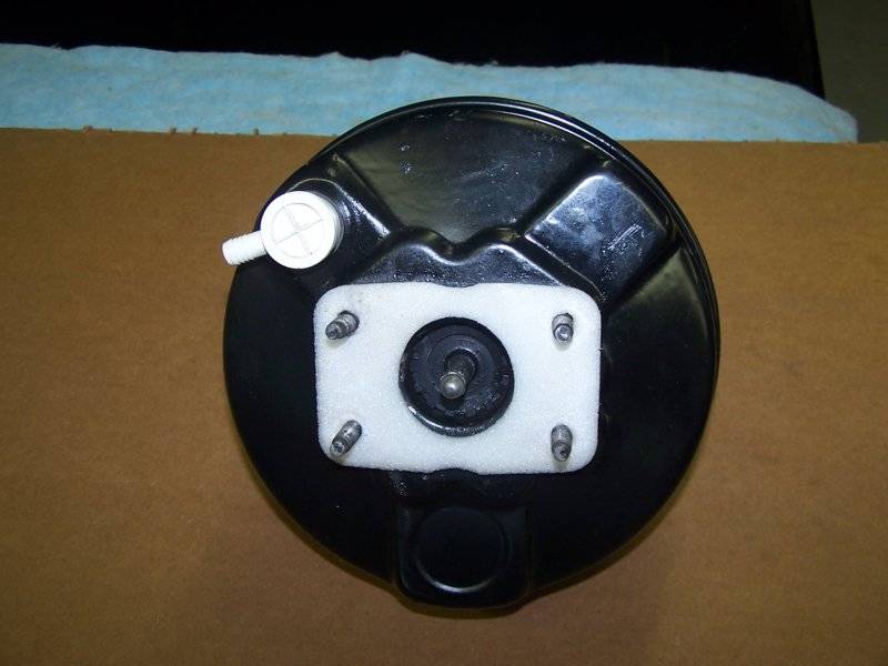

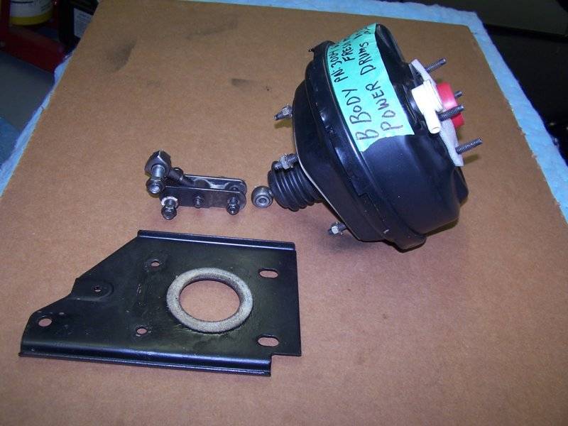

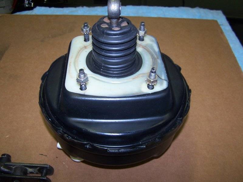

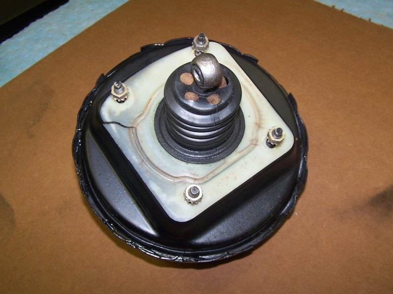

Here are some pics of what you need. (except for the master cylinder) I bought this booster and hardware for $50.00 and had the booster rebuilt by booster dewey but I was not aware it wouldn't work with my front disc brake upgrade. These single ballast boosters are only for 4 wheel drum brakes and do not provide enough boost for disc brakes. I have close to $300.00 invested but will sacrifice for $250.00 if you can use it. I ended up spending $350.00 for a dual ballast setup from Pirate Jack
100_8343.JPG 100_8344.JPG 100_8336.JPG 100_8337.JPG 100_8338.JPG 100_8342.JPG 100_8345.JPG
I've a '68 Satellite and the brakes are not right. They are power drums and the pedal travels further than it should and can hit the floor and not apply a full brake. I don't know if the car was a power brake car or the booster was added. Looking at these pics I wondered if the link the booster and the pedal link both attach to are the same for power and non power brake cars? This might be my issue if they are different. Any one know?
The picture's in post #16 shows the proper parts.
I figured that but if the holes dare in different locations for the attachments then the stroke ratio would be different. What i need to know if the parts are different between power and non power. I know they are different on older Mustangs but I don't know about MOPARS. Thanks for the help
Yes they are different. A non-power master connects directly to the pedal arm.
