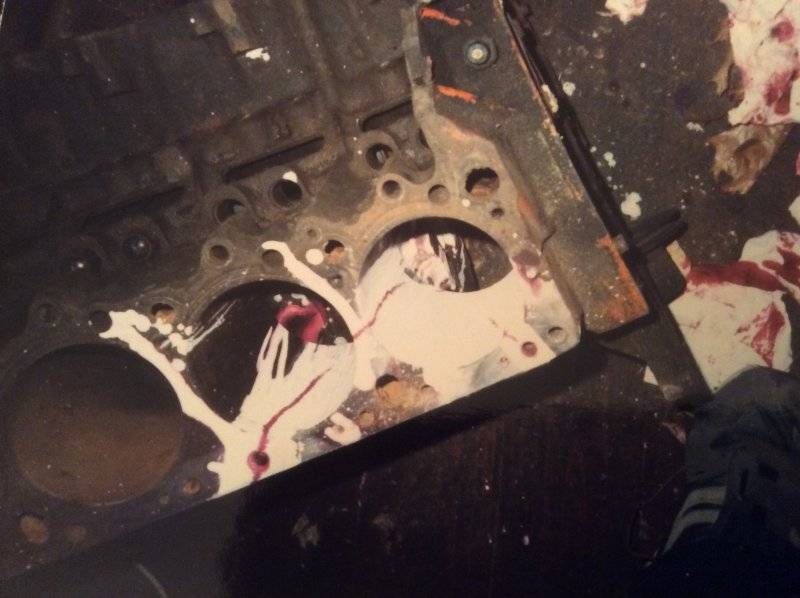

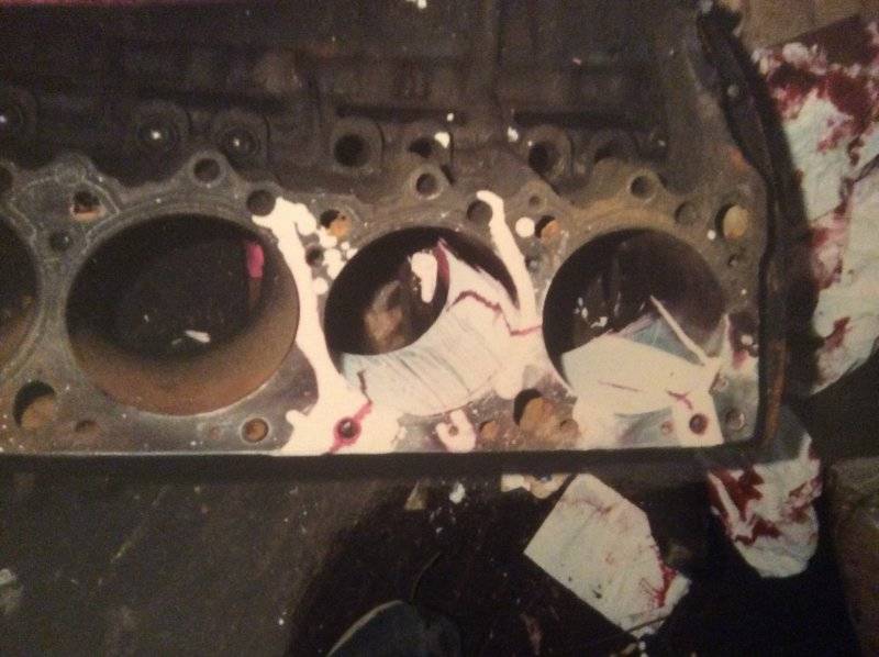

Here's $5000 of frozen iron. Get to heating it!

It’s the block that you should be concerned with. Put the space heater under the block blowing up if you can or at least towards the block. I’d also open the radiator drain and block plugs if you can. After it thaws you could check it with a radiator pressure checker to see if you have any problems. I’d also disconnect the transmission cooler lines before doing any testing.
