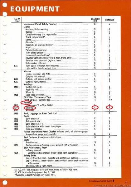

No matter how much you insisted you could not get some things (e.g. a Hemi with AC), but you could certainly order a Charger with manual steering.
I would say yes to manual steering.
Anything was possible back then. So yes you could definitely get a charger with manual steering.

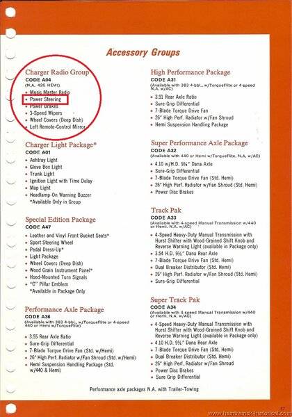

All of them were "manual" until you ponied up the cash for the "Optional Power Steering", code S77 or with an accessory group like code A04 "Charger Radio Group"
It was 1969, not 2019. A LOT of things were optional and extra cost.
Yes. Most still were manual steering in 69. Power steering was still optional and you paid up for it.

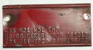

/6, three speed on the column, manual brakes and no radio.
We don't know about PS as it wasn't coded on the tag
