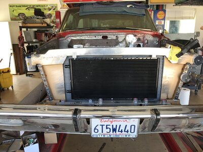

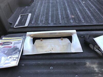

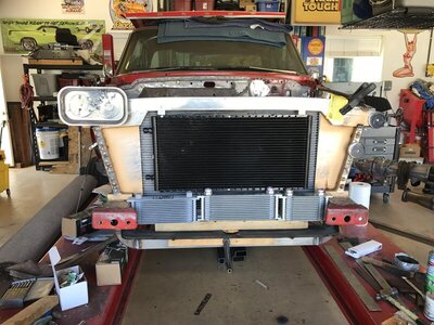

Here is my setup. Engine, trans, p/s. I picked up two core bumpers for material to enlarge the opening behind the license plate. The coolers are mounted on top of the stone/splash shield thats behind the bumper. The enlarged opening will take care of the coolers so they have their own air flow.
