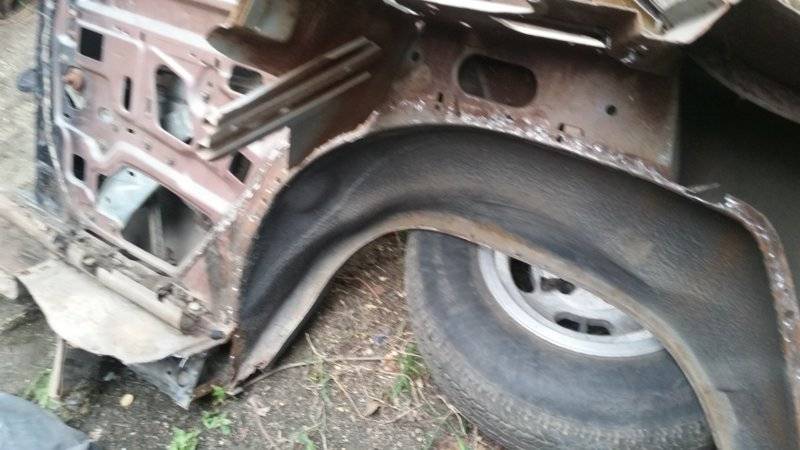

here is the inside of a donor quarter panel that
i have been picking parts off of for other projects like the inner wheel houses (which were not easy to take off)
that are garbage junk from AMD
it is even difficult to get it apart in this disassembled state
some stuff is in a sandwich of 3 or 4 panels together
or at impossible angles to reach with a drill
my guess is he destroys more then he saves for a while until he gets the hang of it
and even then a good amount of stuff will be destroyed.
you have to be a few cars in to really catch on how to attack and finesse stuff apart without killing it.
it will still take me a very long while to get this ready to use.
