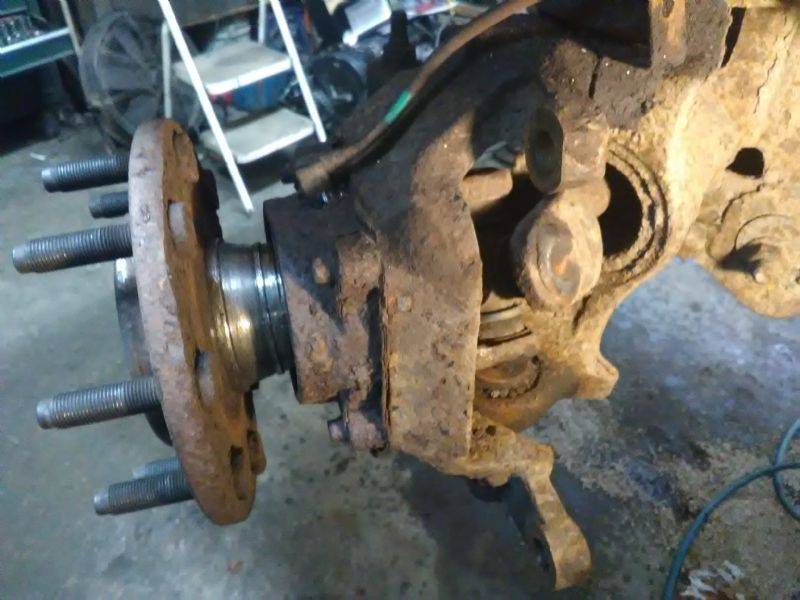

took the hornet to the AMO thing last weekend. came home sunday dropped the trailer came home. got up monday and went about 3 miles and this happened. axle knuckel all junk. i have never seen a bearing go boom like this before. Not blue from getting hot. made no noise or shake nothing just boom. can you imagin it doing that at 80 with a trailer on??? this one is going to hurt the pocket. $$$$
Those unit bearings don’t last forever. Now would be a good time to upgrade to free spin hubs.

Change the other side as well. Axle seals too (and they're a pain).
id love to do that but have ya seen the price of them kits??? 2200 bucks.
