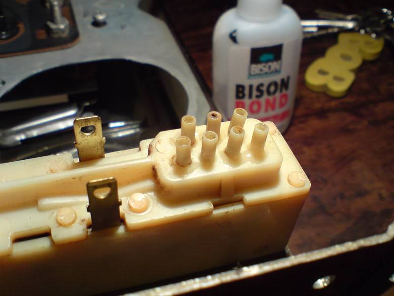

So i'm converting the voltage regulator in my dash into a modern one...It took me ages to remove the dashculster and unfortunately, it didn't work out the way I hoped. The connector from the heater was broken:
Anyone has a clue where I can get these?

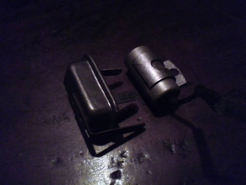

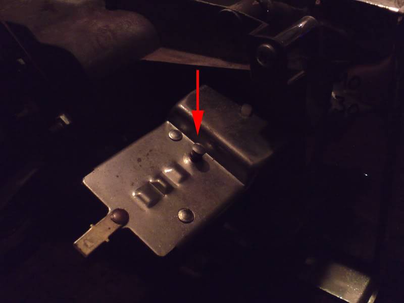

Then, another question. On the back of the light-switch, there's a small button with a spring. What is it for?
I removed these guys and tomorrow or so i'm starting soldering the electic-parts. Let's pray it all works out....
Try NAPA for the heater vacuum switch. The small button with the spring releases the handle for the headlight switch.
Anthony Powell can rebuild it for you:
http://www.dodgecoronet.com/forum/showthread.php?p=77246#post77246

From the 62-65 site tech area:
"NAPA sells a five button heater control vacuum switch that can be modified to work on 1962 to 1965 Mopars. The NAPA-Echlin part number is HC205. UPDATE December 25, 2006: Mark from NAPA writes: It appears that there are quite a few of these switches left, though they have been dropped from the computer prior to 1971 or 1972. If you do want one or more, you’ll have to ask for it by the number. It will have to be shipped in from Virginia, so would take a few days to get there. Not that our cars are usually used as daily transportation, anyway. I’m a fan who doesn’t want these parts destroyed when the company gets tired of warehousing them. As far as I know, this isn’t imminent. But don’t wait too long, just in case! UPDATE July 2008: the switches are still available through NAPA as of this time! "
I contacted Anthony and he can send me a replacement for $85 bucks without shipping...since I'm in Europe, that's going to be quite expensive. Maybe I'll just have to do this because there's no NAPA where I live...damn...
Here's another idea I saw on the 62-65 tech page:
"I've fixed a couple of heater control switches by finding just the right size brass tubing to fit inside the nipples and cutting it just long enough to match the length from flush inside the switch housing to the tip of the nipple. The brass tubing is available at some hardware stores and most good hobby shops. Cut the piece to length, coat outside of brass tube with JB Weld, insert in porthole on switch body and slide broken plastic nipple back in place over the tubing and wipe off any excess on nipple or smooth surface of inside switch housing and make sure the tube is clear. Let set overnight, put it back together. These switch assemblies are held together by 1/8 inch plastic rivets. I cut the heads off with an Exacto knife then drill them out and tap holes and replace with miniature allen head screws from a hobby shop. Then you have a serviceable switch that can be easily disassembled."

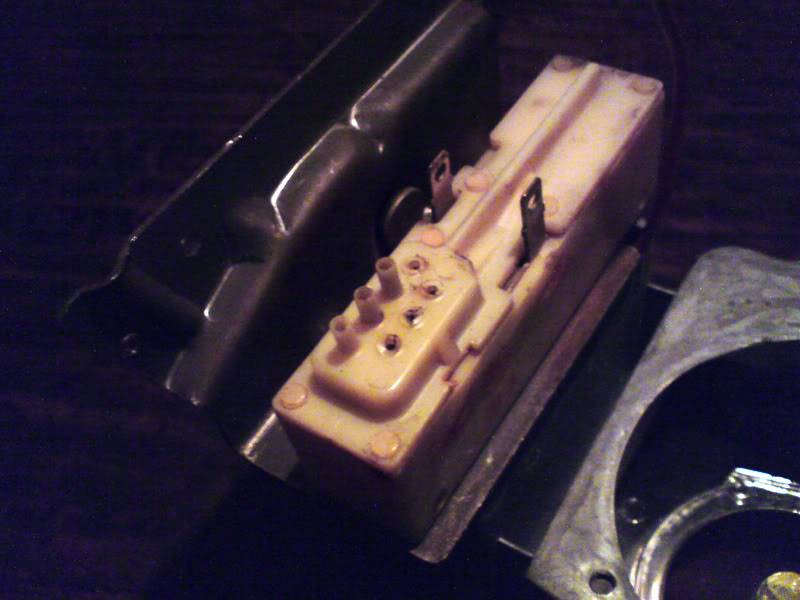

Well...I'm stubborn and tried to glue the pins to the heater control unit. It works out fine. It looks like there's one pin out of line (back-row, the most right) and ...that's correct. haha. Most important thing is that everything is back in it's place again and is working:
