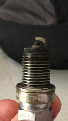

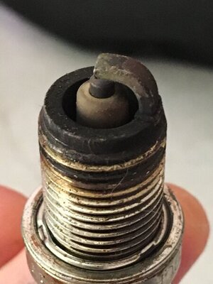

here are pics of the plugs. Not sure what you said to measure.
87F01D4F-7B00-4F37-90EA-4BA5ABDA40E7.jpeg DDB2EFF8-F50C-4E43-939F-3985F55A3652.png
Wish I could go to track more but it’s a 2 hr drive. So only once or twice a year.
View attachment 987393 View attachment 987394
You want to cut the threaded portion off at the base. Of course, that means a new plug, or plugs...
this isn't mine, just a pic I grabbed off the 'net but shows what I mean.
The dark ring at the very bottom of the porcelain, indicates WOT. These in the picture look to be too wide = rich, but gives you an idea.
And, not really relevant to your issue, but yours look rich at idle and close to being too hot..if you can re-curve the distributor to get 20 at idle with the same 32 total, you may get some improved response..just for future thought.
