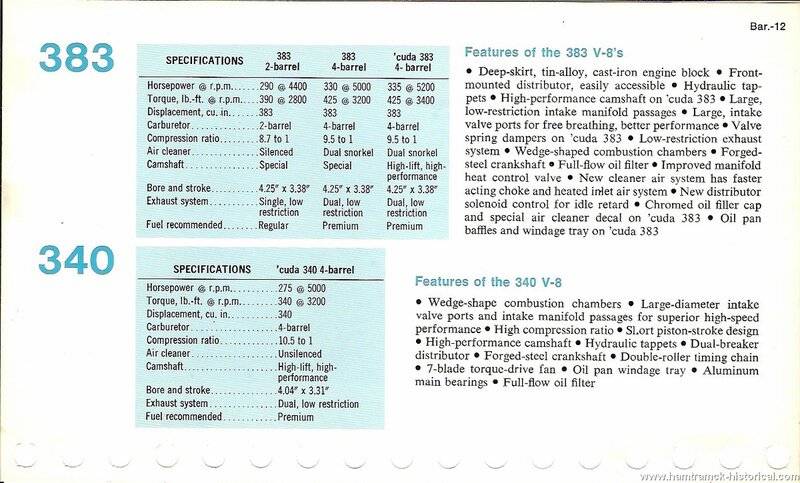

difference between 383 and 383 hp engine from a 69 Road Runner or 70 coronet with 383 hp and 727 tranny
Exhaust manifolds, cam, springs and carb

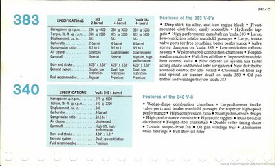

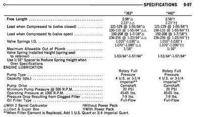

camshaft, valve springs, windage tray and different carb.
Engine code on fender tag.....
925- Carter 4615 avs
926- Carter 4682 avs
897- Carter 4711
899- Holley R4440
First two are orange, stamped HP
Last two are 330hp version, and turquoise.
Exhaust Manifolds are the same if they are 4 barrel engines.
yep, the 330 and 335 motors had the same exhaust manifolds

So there are plenty of differences. Exhaust manifolds are both different. Intake, carb, air cleaner, distributor, valve covers. Compression ratio is lower in 1970 so different pistons.

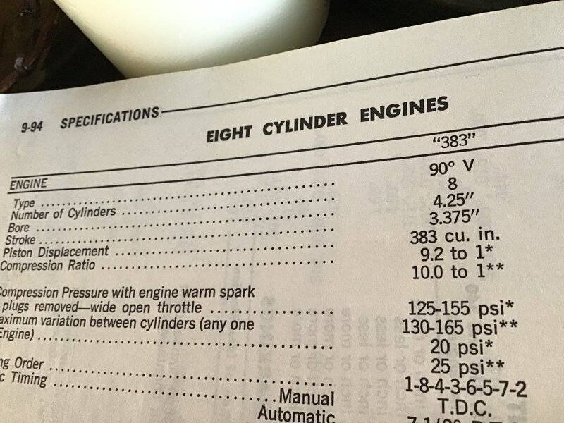

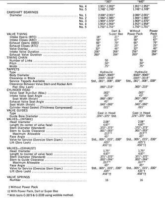

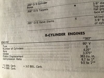

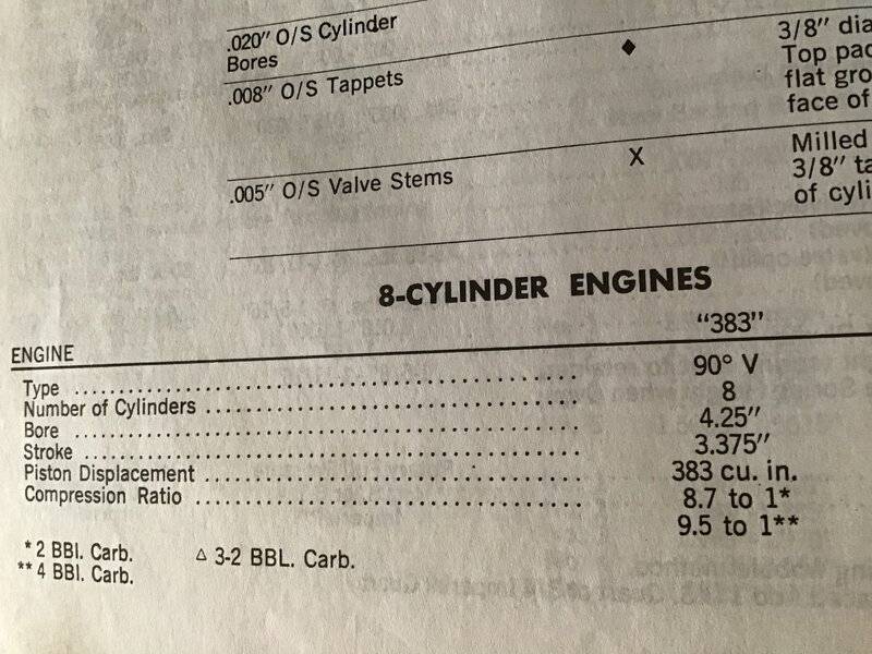

D0930283-35FE-4E8B-9D1B-346F99A15811.jpeg 82BA52BC-D5FE-48F9-9063-4E21F9CA08FB.jpeg

According to the original literature the 70 383hp was only optional with a 4 speed in a coronet(unless a superbee) So a 70 coronet automatic 383 should not be stamped hp...at least if the literature is correct. In 69 a roadrunner got the 383hp...except when ordered w ac.
The only performance difference between a 69 and 70 383 HP is a lower compression piston was used in 70. I think the 70 383 hp is suppose to have a holley carb... 69 is a carter avs.
69 RR HP engine had open chamber heads for that year and had taller pistons to keep compression up. Not much difference in height, but it was a difference.
