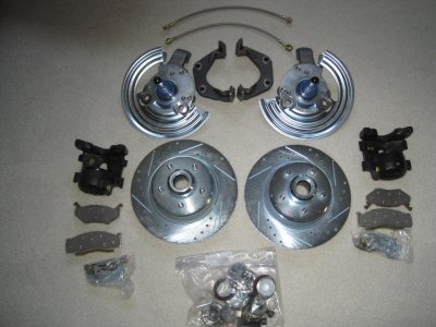

In the end, I went with Cass at Quality Body Shop Drivetrain - Dr. Diff. Cass is awesome - he picks up the phone every time and answered all my dumb questions via e-mail. He even e-mailed me a link from Moparts that showed his install with pics. I didn't go with RamMan simply because Wayne and I couldn't hook up over the course of a week and a half. I would call and leave a msg, he would call back the next day but then I was busy at work. He always returned my calls but after playing phone tag several times I called Cass and never looked back. I got the 11.75" slotted/drilled rotors and proportioning valve. His kit came with everything you need down to the cotter pins. The only thing you don't get is instructions - he assumes you have a FSM for guidance. Not having instructions was a minor inconvenience - the link he provided helped a lot.

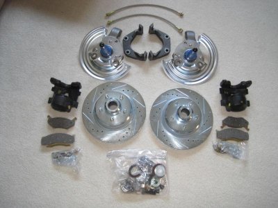

From what I've researched, installation instructions can be spotty, and in the case of Dr. Diff nonexistent, so I'll attempt to guide first timers through the exercise. And again there's great information elsewhere on this site to fill in any gaps. After piecing together the components the conversion is actually pretty straightforward. There's only a few parts - the knuckles, dust shield, caliper bracket and the calipers themselves. Of course removing the old parts is a PITA - most of the bolts are torqued to over 100 ft-lbs and probably have years of grime built up. I took the K member down and disassembled everything off the car so it made access a little easier.

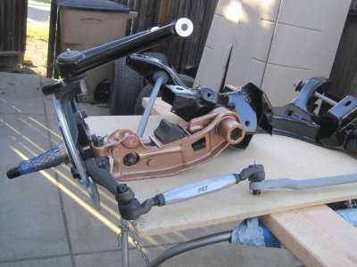

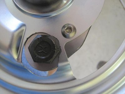

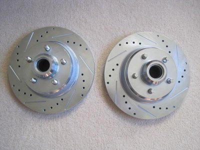

Before you start you must first check everything on the bench for fit and finish. On most kits the inner wheel bearings hang up on the spindle about half way down. I remember Hunt2Elk had this happen during his resto. When I asked Cass about it he said the knuckles are made to fit a range of models and years and some take a larger bearing. It takes about 10 minutes with 180 grit sandpaper to knock the spindle down to size. Cup the sandpaper in your palm and rotate it around the spindle for even coverage. Another thing - the rotors come with the races installed and the conversion kit comes with Timken bearings and races. Cass recommends swapping out the races. I had a brake shop swap the races, lube the bearings and install the rear seal; they were installing new bushings and pivot shaft in my LCA too so I got everything done for $80. I'm glad I did it because the original races that came with the rotor had scratches in 'em. Afterwards slide the rotor on the spindle and make sure it slides all the way back and spins freely. BTW, the conversion kit was made by The Right Stuff; the calipers came from NAPA auto.
I'm assuming you're familiar with disassembling the front end. Separate the knuckle from the upper ball joint, the lower ball joint from the outer tie rod (leave it attached to the knuckle), the LCA bolt, all the brake lines, flex hoses, etc. If you're keeping the original suspension parts then use a gear puller; if you use a pickle fork you're going to be replacing parts.

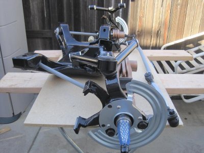

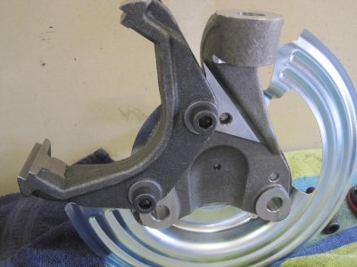

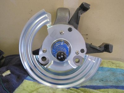

After you've checked everything and are good to go, the first thing to do is install the dust shield on the front of the knuckle. BTW, the knuckle and caliper bracket are cast metal; I painted them with Hi-Gloss POR-15 before installing. The pictures were taken before painting to show more contrast. If your car doesn't have a factory sway bar then the caliper mounts to the front. On the back of each knuckle is stamped a L and R. Naturally I figured the L was driver's side, but when I attached the dust shield it was obvious the caliper attached on the rear (there's only one way to attach the shield and bracket). Another call to Cass; he said ignore the L and R, the knuckles are interchangeable side to side. Whew!, one obstacle crossed.
Next, install the bracket on the back of the knuckle. You're going to need a large Allen head wrench - don't know the size.
Install the lower ball joint - if the ball joint hasn't been replaced in a while now's the time to get a new ones - they're cheap. I had to break out the Dremel and grind back a little of the dust shield to clear the ball joint bolts.

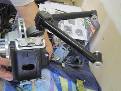

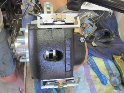

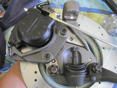

Position the caliper on the bracket - this is a slider kit so there are no pins. The caliper and slider bracket (thin, shiny piece) attaches with one bolt. Bend the slider bracket tab downward to limit the travel of the caliper. The kit came with a rubber band as an anti-rattle guard - I installed it but it will probably only last about 1 mile before snapping. The caliper comes with the OEM style banjo fitting and stainless steel flex.

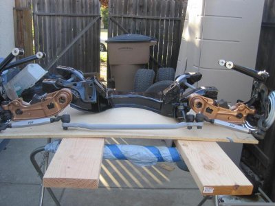

As part of the suspension upgrade I got tubular UCA's from PST.
Here's the finished install. Assembly was the reverse of disassembly. Don't forget to torque all bolts to factory specs. It's gonna be a while before I road test it. All I can say is if you're on the fence - go for it! Once you get into the install it's really not difficult.

Was wondering how the rubber bands were installed on the calipers. Dont remember right off hand if I have it for the calipers to be mounted in the front or rear of the spindles. I did upgrade my original sway bar with a much larger than factory.

Thanks for the reply. You're a couple of steps ahead of me - I still have to figure out what to do with my engine. With the front sway bar you're probably mounting the caliper towards the back. As for the rubber bands, take a look at the close up pic of the caliper you can barely see the band wrapped around the aligning tab. I don't know if that's the correct way, it seemed good to me. The FSM has all the torque references; you should really get one if you don't already - I believe you can get copies on Moparts.com.
