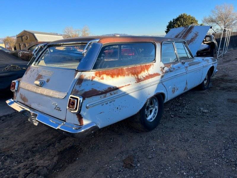

Hello All,
I'm doing a Disc Brake conversion on my 1964 Plymouth Fury Station Wagon. Just got off the phone with Pirate Jack and the guy says their 1962-1964 B Body kit won' work on my car. He says it's a C Body, which from my understanding it's not. I checked a CCP kit and they're currently 40-45 days out. I've dug into Dr. Diff and they look to be $150.00 more than Pirate Jack and $250.00 more than CCP and that doesn't include a brake booster. Any thoughts?
I had a hassle with a kit that was for '65 - (have a '63) seem to recall these era cars, up to '65, had a bell-crank yet? Ended up making it work after more sweat and expletives.
Dr Diff is a great resource. I would only consider his conversion kits.
Thanks for the input. Well the plot thickens. After posting my original question I reached out to Mancinni Racing who is a vendor for MBM brakes. Found the exact same part number as Pirate Jack, called them and they said the kit would fit!!!!! But they are about $250.00 more than Pirate Jack. I've reached out to Dr. Diff. I don't understand on their website about upper ball joint adapters.
What is the bell crank you're referencing? If it's the kickdown I've gone to a cable.
It's linkage that changes the direction of force such as pushing action generating a pulling reaction. Memory is foggy, I think Chrysler had them on power brake pedal assemblies up until the mid-60's - I believe my '63 had this and became an issue as I converted from manual to power brakes. Pedal 'ratios' are different btw manual and power; there were two holes in the pedal arm. Top was for manual and lower one for power with a crank setup. Ended up converting the brakes to retain the top position, longer story on this. Anyway, this may have nothing to do with your situation, especially if your car already has power. Just mentioning it. For more info you can do a search on this site for 'Brake pedal bell crank' there are several threads.
Again, Thanks. My car is a manual brake car. Maybe the picture of the kit, "DBK6272-MP-202", I'm looking at has two "Bars" that I don't recognize. This is the MBM kit. Perhaps those bars give you the option as to if your car is a manual or a power? I'm not following you when you say you ended up converting the brakes to retain the top position. I'll have to look at the threads you mentioned. Here's the car:
