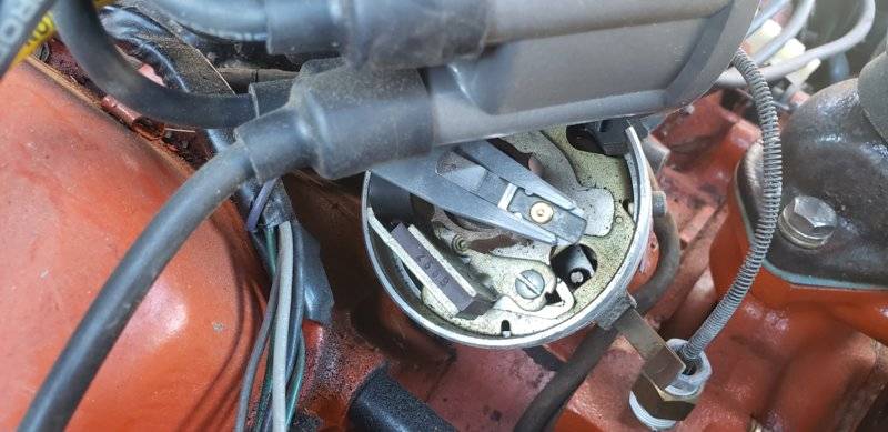

Aluminum tag says 3690431. It is purple. Above the part number 38 9....
Does anyone have a date or year application for this distributor. I cannot find it in my book?

Don't know. It is what I have. I have been having issues where my 383 fires up on the first revolution, runs for several minutes and then the engine just shuts off like flipping a switch? I am looking into maybe a bad distributor?

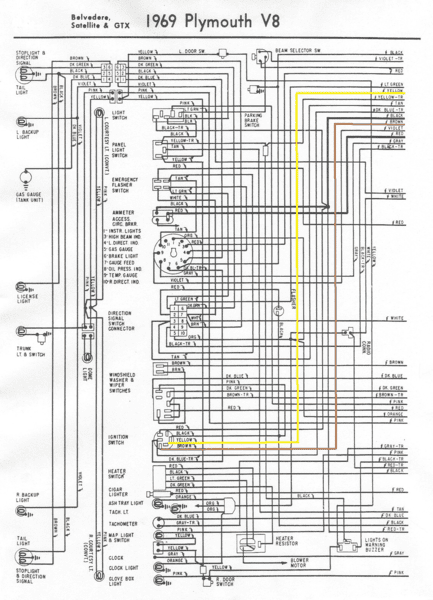

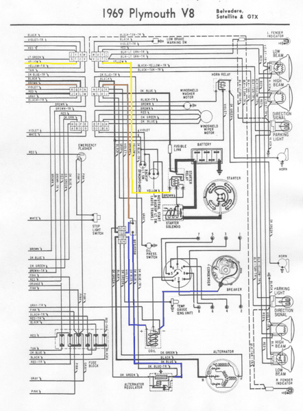

Check your bulkhead connections. Sounds like its getting the ignition side but not the run side. Look at the schematics for your cars wiring. I would check that.
You may have two diff problems, tranny linkage adjusting and ignition switch backelite coming loose what makes contacts get a gap. They are not related.
The tranny linkage will make to crank or not, but will never stall the engine once running
Here even though we dont know what you are working on.... Most of the ignition is the same for most of the cars.
Yellow,Brown and Blue are the wires you will be dealing with.
I just ordered my colored schematic for my 66. I got the 66 manual but it is hard to read those in there. IOt is a 66 383 automatic charger.
