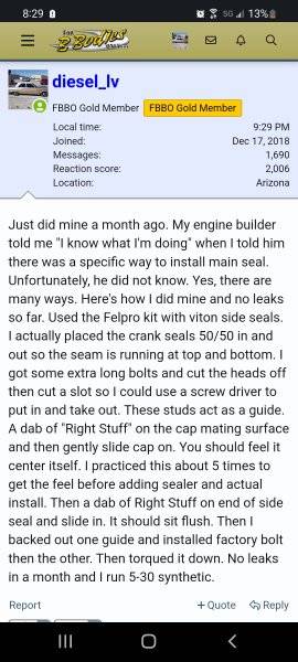

I did mine not too long ago. Couple thousand miles on it now n not one drop.

awesome. Another idea to try. Thanks for the info. Did you drop the rear main cap or did you leave it in?
The only thing I removed was the rear main oil seal retainer cap. Not the bearing cap.
