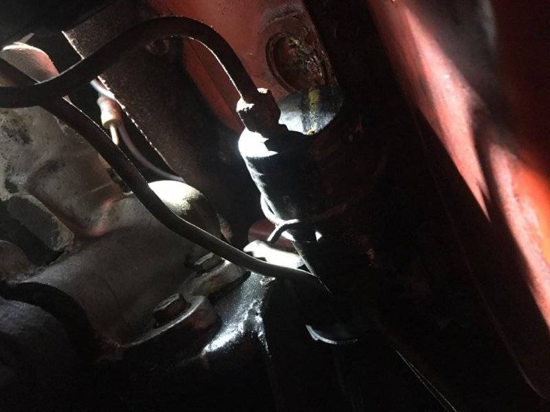

Recently purchased an original '63 Polara with a poly 318 and 727. Just starting to do some maintenance on it. The transmission filter is a "can" that is inline with the trans line, It is original I've seen them before, but now I own one. I haven't dropped the pan, therefore I hope that someone might tell me if there is a regular pickup in the trans that I can swap to a later in pan filter OR better yet, are replacement in line filters available. I checked Rock Auto and they show a typical in pan filter for a '63 but for '62, there is nothing.
I appreciate any replies.
I believe those early 727's also have the in-pan filter screen on the pump pick up.
That trans should have a front and rear oil pump and will have 2 suction holes in the screen.
I have never seen any original external filter assembly on a 727, that is installed in the line to the radiator?
Any pictures by any chance?
For the filter cans you could measure the original filter o.d., i.d and length and find a replacement filter from a general brand that has a suitable filtration size.
Yes you can change the pan and remove the screen and replace the filter.
The filter has a 2 pickup for the front and rear pump. They are still available.It's been awhile, I would do a search.
Also a GM can fuel filter late 70's has standard fittings and not metric. Some have used this filter successfully.
How is it attached to the line? Hose with clamps or flare nuts? Sometimes manufactures would supply a filter that you placed in the return line of the trans. This was to catch shrapnel before it got into the trans and wiping it out. Mostly just a band aid. There may have been a TSB, technical service bulletin, from the mother ship back in the day to do this. I never saw anything from my dealer parts days with Mopar. I did see it when I was working at a Subaru dealer. I would eliminate it and either make or buy a new line.

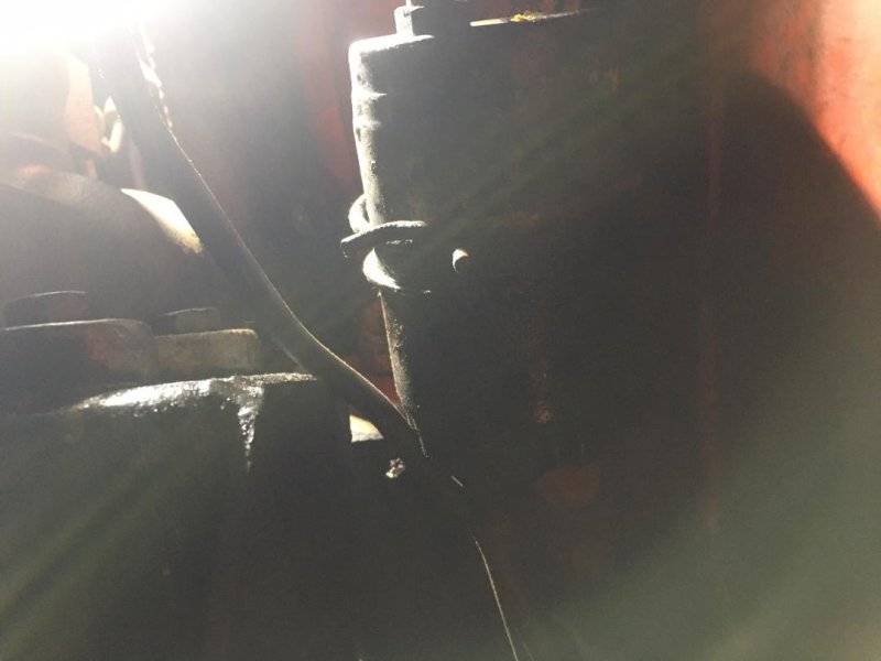

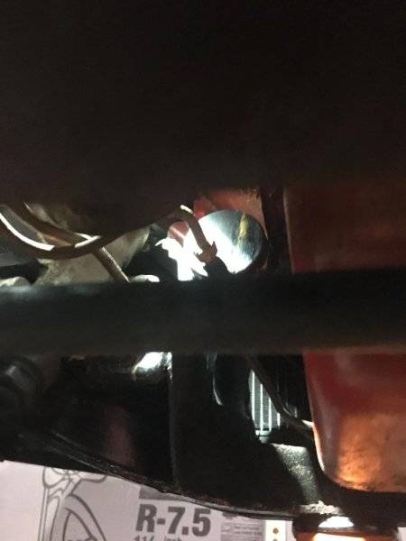

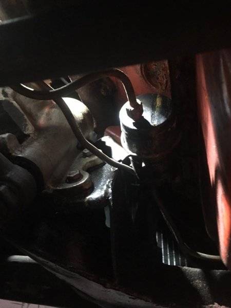

It is a factory inline filter. In front of the starter. 1962-63. Bolts in with flare fittings. I’m not aware or any new ones for sale.
Yes in the pan is A filter, you can’t change the filter type to the newer design, you need one with the 2 holes for front and rear pump. 1966 and newer have one hole.
Thanks for the replies R413 is exactly right about my in line filter. As soon as I find a source for type A transmission fluid, I am going to drop the pan. If I can't find another factory in line filter, reluctantly, I'll bend up some new transmission collant lines. 50-60 years ago, when I was racing Mopars, we used to use type F. This car is so original that I am doing whatever I can to keep it that way.
...and a newer pan for the deeper filter. The original pan won't go on with the newer style filter.
I'm using Type F in mine. Walmart had it the last time I needed some.
I installed new cooler lines and eliminated the inline filter. Had to obtain a newer pan which is just a little deeper to except the new style filter (two hole) Good luck!
I did a stock rebuild on my 65 Coronet and used Mopar ATF+4 fluid. Works great. Check the specs for ATF+4 and you will find it beats all the older type fluids in every category.

Getting back to the transmission filter; I think that I'll search for something about the same size as the original and use it. My pockets ain't deep enough for a factory replacement.
I really do appreciate all of the answers.
John
I agree with all above. Dextron II ATF+4 or Type F . TorqueFlights are happy with any of the three.
