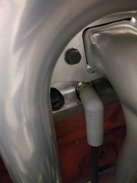

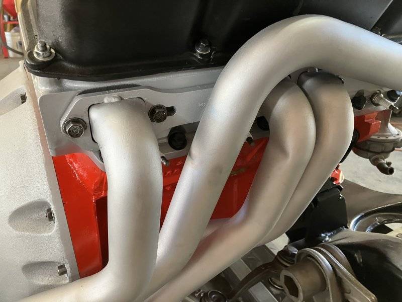

The issue that I'm having with these angle plug heads is with #6 plug. Seems with all the headers the #2 tube runs across the top and then drops at a 45* between numbers 6 and 8. The #6 plugs angles right into that tube. Looks like the Dougs headers are not any different than the Headmans that I have. Looks like on the TTIs the #2 tube drops down further back giving the #6 plug more room. Guess I'm calling TTI in morning, again.

Like this?
These are TTI 2".

Like this?
These are TTI 2".
Thanks for the pic KernDog, I can see the tube there is slightly more angled than on my 1-7/8" TTIs. Flange bolt access is also easy.
Here's mine in that area,
Lots of room for the #6 plug and flange bolt. The limiting factor is the shock tower.
Okay you guys are awesome! The 1-7/8 are the ones that I like. The tube is more vertical giving more room for both #6 and #8 plugs. Why in the hell can't they all make headers like that? What is so hard about making **** that fits properly? Being a retired Sparky I'm all **** about headers and plug wires. This will probably be about the 15th set of ITTs that I've installed. Have 3 cars in the shop right now with them.
