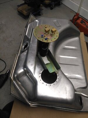

Tanks Inc. pump with sump. 340 lph. Mild 440 in a 67 Charger. Fitch 600.
Definitely use an in tank pump. Stay away from inline pumps. I used 3/8 fuel line and GM filter/regulator
