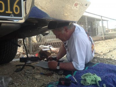

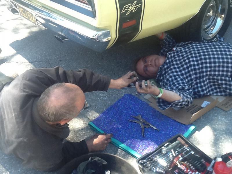

Edelbrock Street 125 gone. Ma Mopar Carter mechanical installed. Starts better cold, hot, and in between. Rid of the regulator too. Two roadside breakdowns cured me. I need the reliability if a mechanical pump. You can't count on car guys to help you on the road. I got lucky. Darius and a good samaritan bailed me out. Twice. On one trip. Saltan Sea, and Alta Vista. Middle of nowhere both California style. Only 25 miles so far, but it runs better than ever. Car Show owners who drive locally can survive with an electric pump. Not me.
