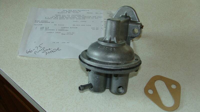

So I called Then And Now about rebuilding my Carter 6903 from Mike Casella. They told me Mike retired last year and Tom is rebuilding them now. Anybody had there fuel pump rebuilt by them lately?
Just got my airtex back from rebuild
, nice company
