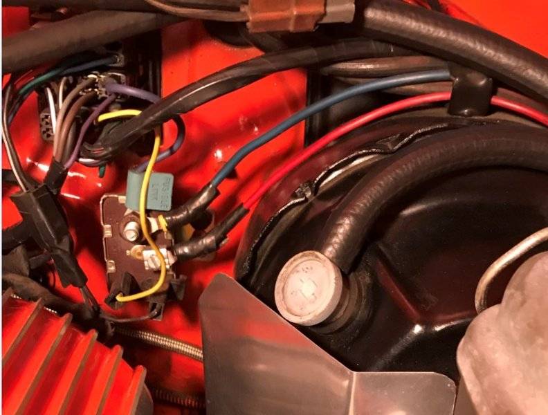

O.K. I hear ya. I got a distributor and voltage regulator that did that. I have a picture of the relay and wiring, to show that its all new but I will definately start with new wiring from the battery and possible just make a new harness for it.
by new I meant wiring and bulkhead the relay is about 5 years old.
Check the ring connector on that blue wire.
