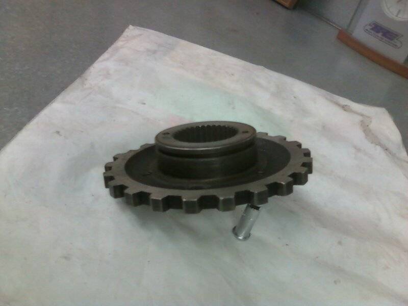

The park pawl and the wheel (can't think of what it's called) it engages can't weigh a combined 2 lbs! I can't figure why you would want to remove such a simple mechanism that works so well?!
I thinned my park gear down. Removed the governor. Put a new snap ring groove in the shaft.
Park still functions.
