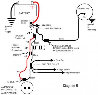

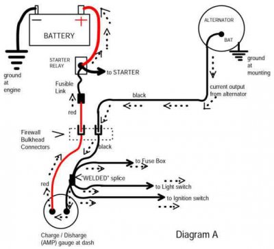

yeah, it would be nice to have a stock location volt meter. These diagrams are a great before and after way to upgrade the electrical system though...great find burntorange!!
