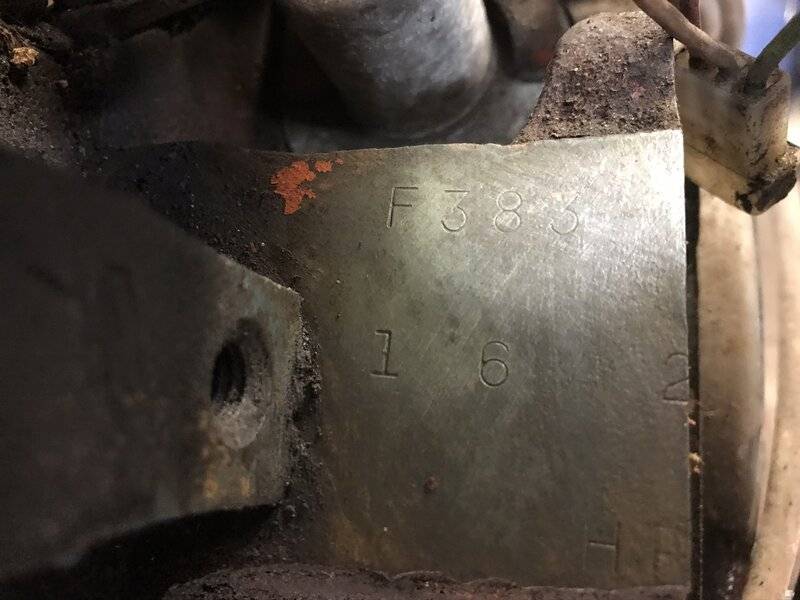

The distributor is above the letter F in this photo
The numbers are on the flat that's in the dead center of the pic
If a 383 gets decked the numbers may be gone. It's the same surface as the head.

Ok, I moved the alternator, and here's what I found:
D 383
2 12
Should/are there any more #s? I figure that "D" isfor April and 383 [thank goodness] is 383 cu. in. What do the other numbers mean?

Please see my other post......I had to sandpaper the paint off [engine is clean.......D 383 and 2 12......can't figure out the 2 12?
