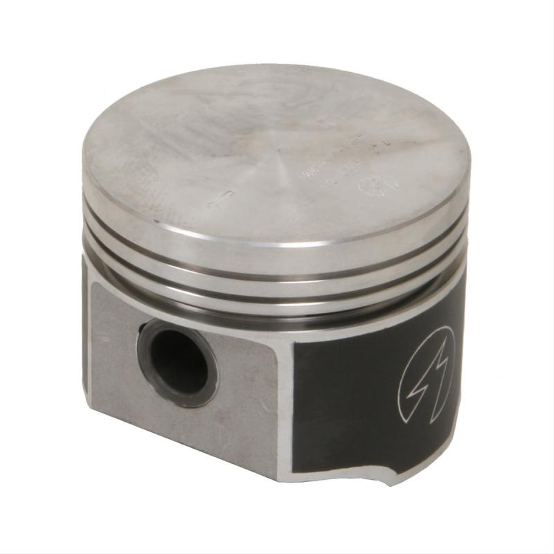

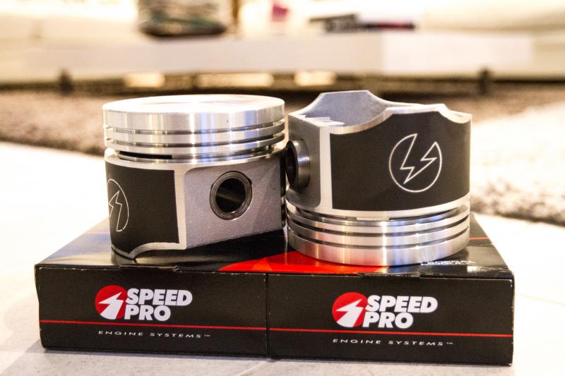

We needed pistons and rings ASAP so I have now a set of Speed Pro Forged flat tops and their Plasma moly ring set to suit.

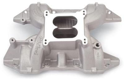

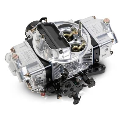

I also ordered an Eddy Performer RPM manifold and Holley 750 Ultra DP with electric choke.

Pistons and rings showed up at the front door today!
