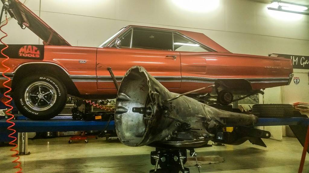

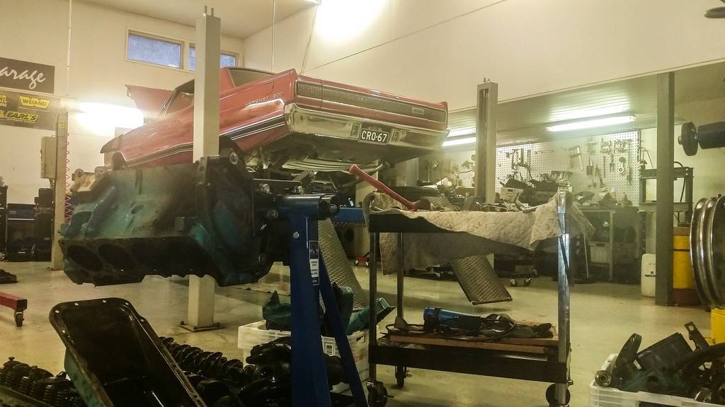

Today a mate and I took the engine out, gearbox out, removed the Diff center too. Then we disassembled the engine as well. SO it is now ready to go to the machinist for cleaning, checking and any work that it might need. From the looks of it, not very much work is needed. We will most likely line bore it though, since one crank journal looks to have suffered from lack of oil, most likely at the start of it's life.

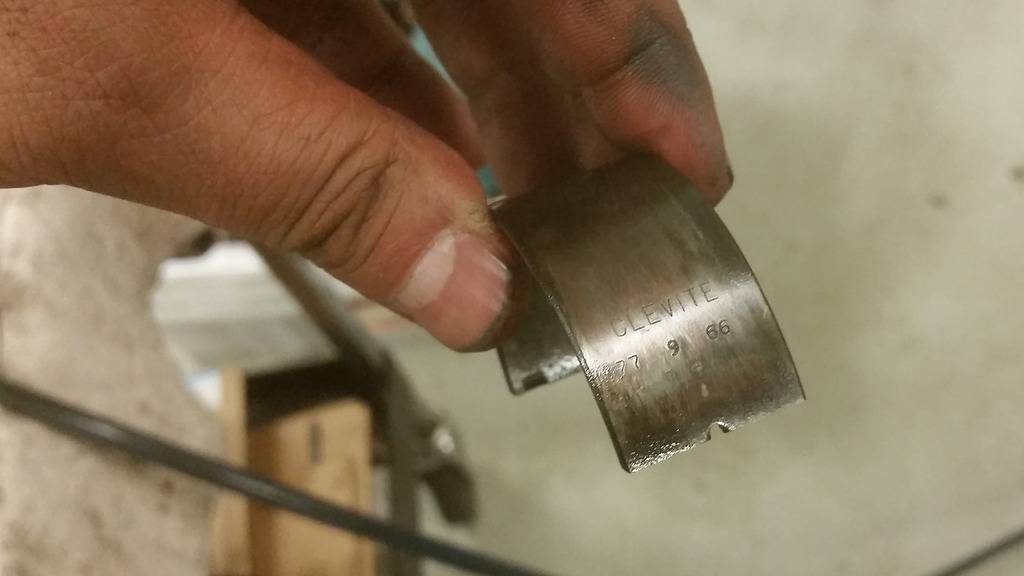

Check the stamp out on one of the cam bearings:
From what I gather, bearing is Clevite 77, stamped 9th month 1966. if I am wrong about this please let me know. But if this is correct, it all makes perfect sense, since my car was built November 22nd 1966.

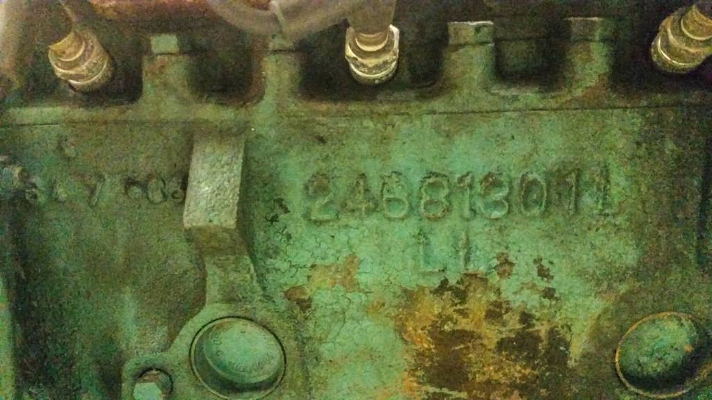

More evidence, My block has the cast numbers and what I believe is the cast date:
2468130 put's the block in the correct time frame and the 7 66, would be 7th month 1966 cast date..What do you all think? I believe this is correct, and fits with my cars build date.

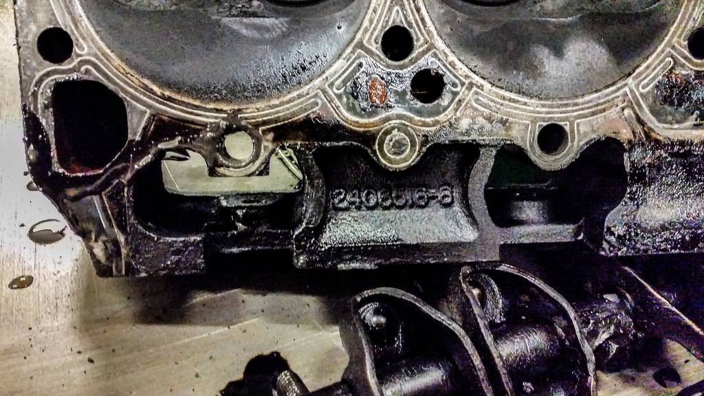

My heads have the numbers: 2406516
I am not using them, although they are in great condition. But I will clean them up and store them in case I sell the car and the next owner wants to take it back to stock. (for the record I am never planning to sell this car..But silly money offered..she's gone LOL)

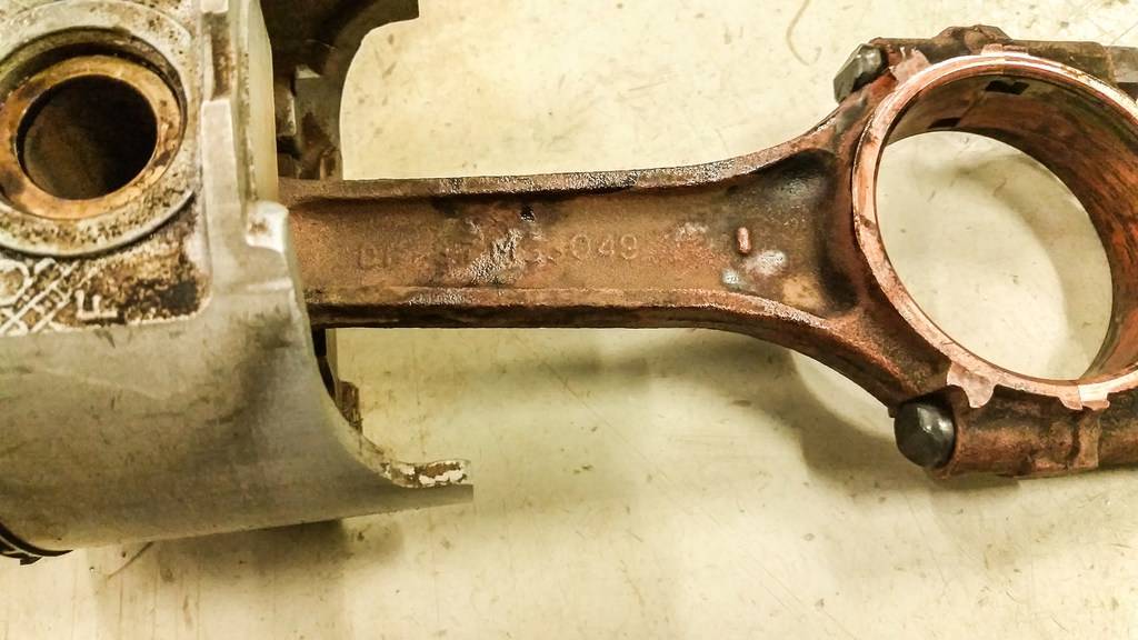

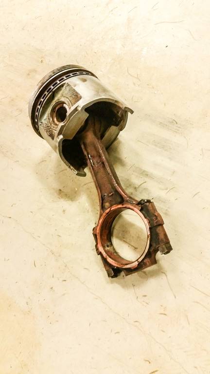

Since everything points to this engine never being worked on, at least the bottom end, we could not work out why the color of the rods were like this? Forgive my ignorance on big blocks, as this is the first one I have ever pulled apart that was original. And all my other builds back in the day were on Mopar small blocks. But I have never seen rods like this (color wise). Did Ma Mopar coat them with copper?

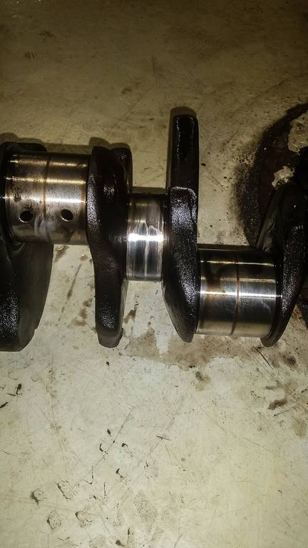

And this is why we are going to check the crank for straightness and line hone the block.
Looks like this journal starved for oil at some point.
None of the other journals or mains show any signs of movement or vibration. Piston walls all look new, bores are still rock stock bore size. So we will go 030 on this when we bore it. (purely because 030 pistons seem easier to get than 010. I am not sure why this is? Anyone know?
