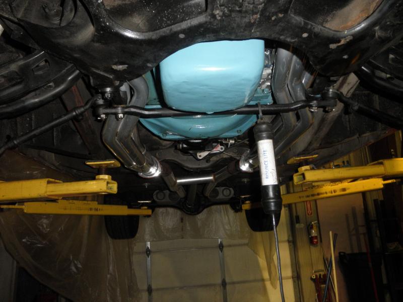

Sonny can't hear a dam thing!.......even blast my speakers when driving with the windows up or DOWN.:icon_shaking:
