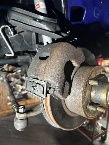

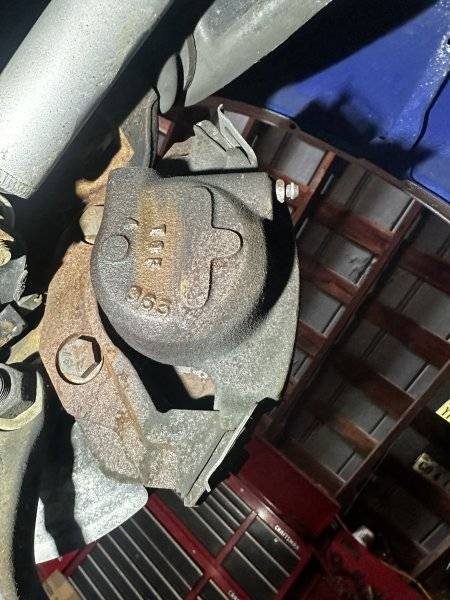

Does anyone know if this is a factory brake caliper? Eventually I plan to upgrade the front disk brakes. Due to funds I just need a basic replacement for this car.
Are there any dual or four piston calipers that would bolt up the factory mounts?
Yes. Upgrade that, or another car ? Basic replacement of what, the entire setup ?
Just brake calipers pads and rotors.
What you have IS the upgrade! Factory 4 piston brakes are not any better than what you have now. Hard to find parts and expensive when you do.

73- A-body and several other cars. Looks like you have the 10.75" rotor. You can kick that up to the 11.75" giving you more swept area and leverage. Dr Diff has the caliper brackets to do that if you don't have a source on good used ones. The Doc, Rock Auto and your parts stores have/can get the rotors. Cordoba, St Regis, Magnum etc had those. If you get a good replacement semi metallic pad, not used car lot specials, those will help improve the braking. However...the bigger rotor doesn't fit 14" wheels. You need 15" minimum.
those are “slider” calipers. Typically a swap from a 73-76 A-body.

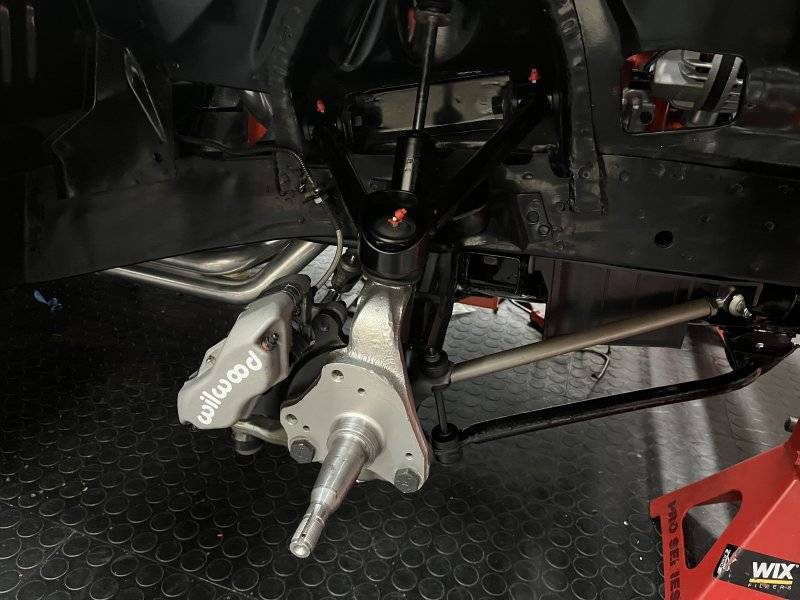

Dr Diff has caliper brackets to install Wilwood 4 Piston Calipers. You retain the stock rotors so it’s significantly cheaper than a complete Wilwood kit.
