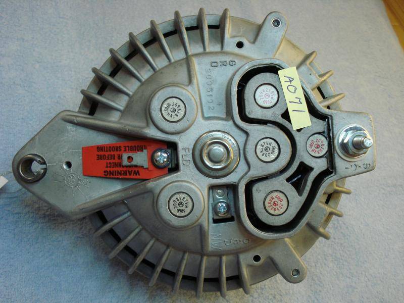

There is a reason why alts from factory got a red label on field warning you to not disconect the wire while engine/alt is running.
I would install the switch before the regulator. I don't think the switch after the regulator will be a good idea. WHY? The regulator would keep working trying to compensate the voltage decay still if alt is not being feeded and some damage (INCORRECT ASSUMPTION .. NO VOLTAGE OR CURRENT WILL BE FLOWING = NO HARM) could float on as soon you activate the switch with engine running. WHT IS THE REASON ?..... EITHER B4 OR AFTER THE REGULATOR? THE ALTERNATOR WILL NOT CHARGE IF IT HAS NO FIELD VOLTAGE APPLIED.....PERIOD
There is a reason why alts from factory got a red label on field warning you to not disconect the wire while engine/alt is running. WHICH YEAR, WHAT CAR, WHAT ALTERNATOR, WHERE IS HIS TAG LOCATED

tag!
tags reproductions
1966-74 A B E-Body Alternator Warning Tag
DD0435 1965-1970 Chrysler models Alternator Warning Tag.

tags reproductions
