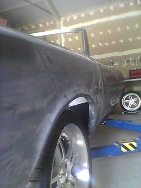

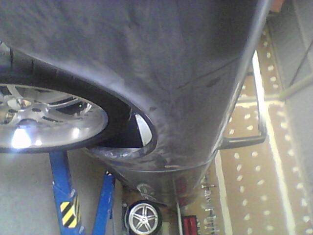

the GTO was approached withe tape and build approach...is a rotiss, had aftermkt qtrs(not AMD{before me])..all wheel arches were built in sections as described with kitty, duraglass, ,, duraglas/finish putty combo. it's mini-tubbed, so there was a lot of blending arches with new wheelhouses. Have photos from car on jig to a rough assembly if anyone wants to see them. jimiGTO side in 400.JPG

attaching photos of Goose because......well because it was mine & the only GD car i've ever been able to do for myself...hell of a practice canvas...now if this had been Yours, wouldn't You be prone to reveling in & reliving the memories? Wouldn't You be likely to show it off and say, this was mine...i may be an also ran, but i DID run. substitute a Daytona or Superbird.....damn right You'd be singing to beat the fat lady....dem Mopars are still production assembly line cars...da Goose is hand beaten, hand built.....only 401 so it's apples & oranges @ end of day........my 68 post Coro was a faster car though....the Goose was an undeveloped prototype, possesed with the right hardware, just wasn't ever R&D'd & sorted...the main handling ill was unpredictable rear camber due to manner in which ZF was hung...takes 200.00 worth of fab work to cure the problem...couple little trix and they'll kill a hell of a lot more than Cobras, but in stock form, they behave on a well kept line, offer wonderful feedback & feel within adhesion limits, but i could drive circles around myself with a stock 318 B-Body.Screen Shot 2015-03-29 at 4.23.49 PMGoose A.jpggoose C.jpggoose D.jpggoose E.jpggoose F.jpggoose G.jpg8ma580-001.jpg8ma580-003.jpg8ma580-005.jpg8ma580-007.jpg8ma580-009.jpgMine is 8MA-1148....the metallic blue car is 8MA-580.....this Guy got real serious...this is pure race car **note doors with plexi curtains** rear frame completely re-worked, machined His own steering knuckles ..i know why cuz i snapped one one night....stock spindles/bearings & knuckles are Fiat 124, but amazingly, with all that rework, those are the OEM Girling brakes, same as 289 AC Cobra......very good brakes. My Goose never once refused to run.

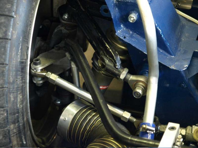

Was Working on GTO today.....wrapping it up for final prime 600+ hp/550 ft lbs LS-2 married to Tremec 6 speed....that just the beginning...full undercarriage menue bumper to bumper...Hotchkiss/Wilwood (SIX piston/14.5").
