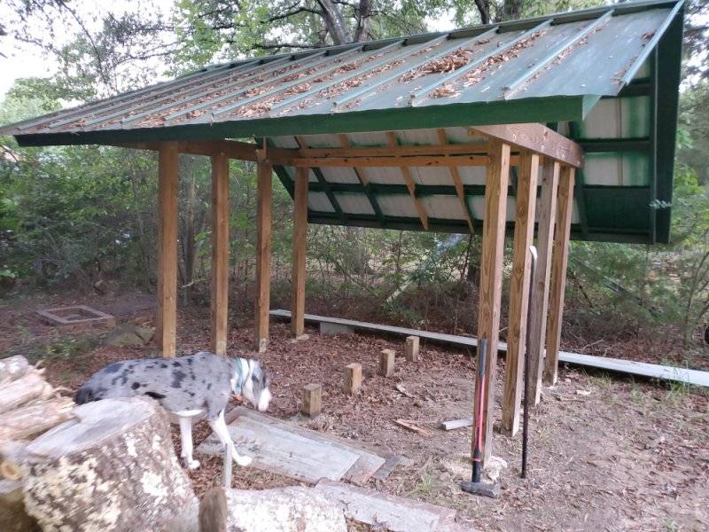

Those look like turkey feathers? Tail feathers from a male. I could be wrong, but I'm pretty sure.Been a bit busy this week . . . lots of progress on things . . . Lots to report . . .
Trying to get back to the shop build but this firewood building is in the way and has to be moved . . .

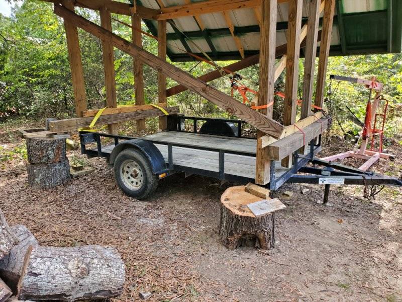

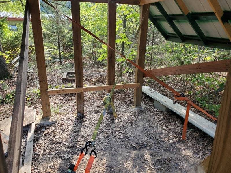

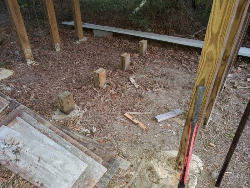

Got all of the cross members removed from the structure . . . the things that held the wood off the ground . . .
Which left me with this "mess" . . . and being built BSH . . . the 4x6s have rebar in then to hold the concrete . . .

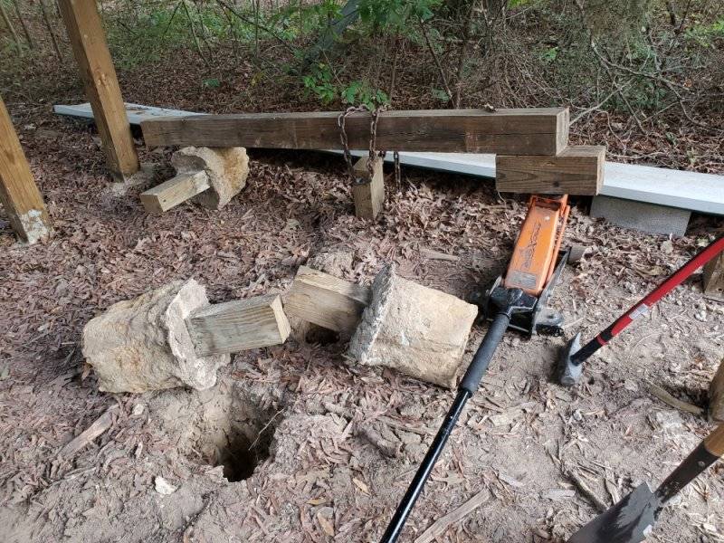

So I came up with a plan . . . Plan A . . . Grabbed the floor jack and a very big 6x6 and a chain . . .
The plan was to use physics . . . fulcrums . . . and try to use leverage to get them pulled . . .
And it worked . . . 1 down and only 3 to go . . . The mosquitos were trying to carry me off and drain my blood !

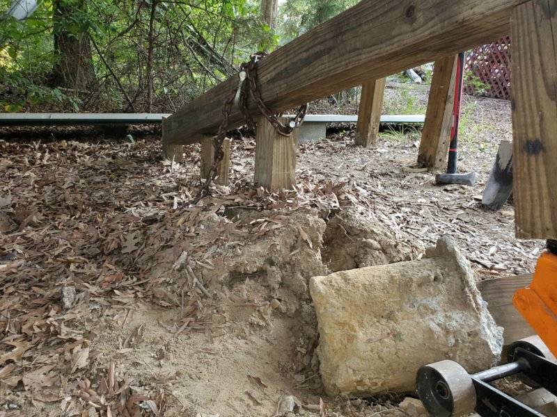

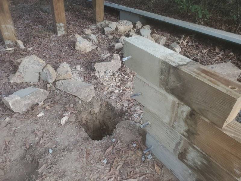

The second one was very interesting . . . always joke about the Carolina clay being like concrete when it dries . . .
This being under cover for 3 years . . . look at how it's buckling and the concrete is being pulled out of the ground . . .

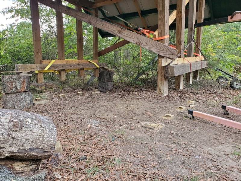

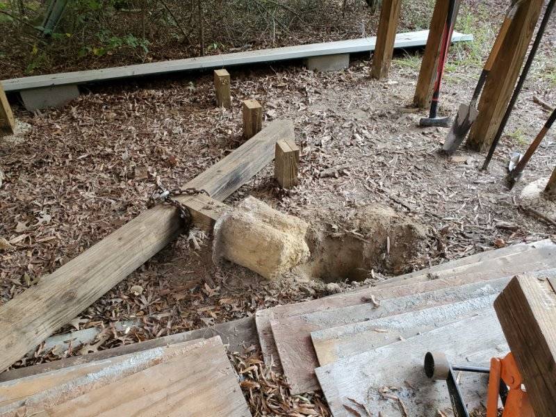

Had a minor issue with the last one . . . no more posts to use as the support for the other side . . .
So . . . just grabbed one of the concrete slugs and put it to use . . . before I broke all the concrete off . . .

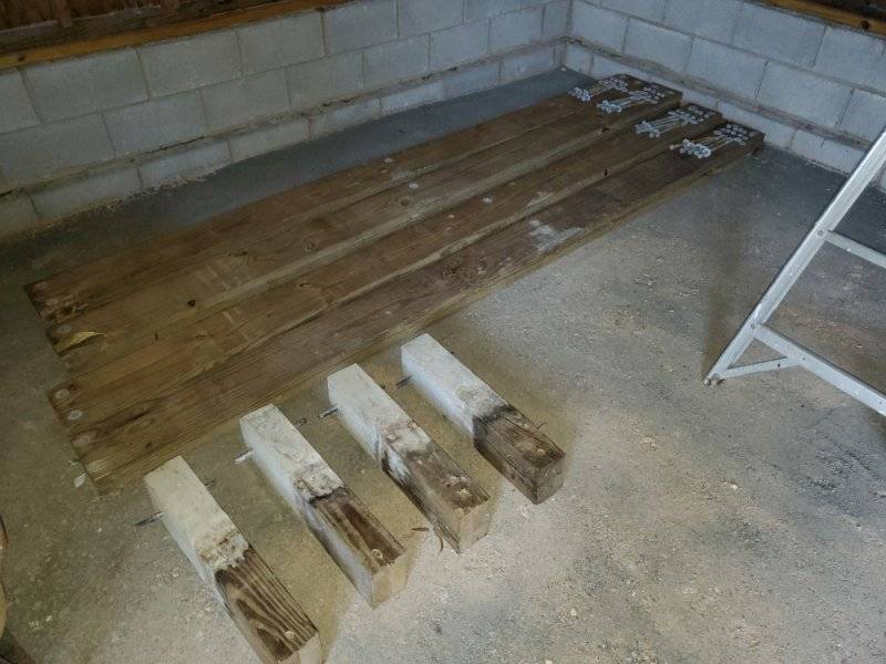

Busted off all the concrete . . . and now you can see the rebar that was put into the 4x6s . . .

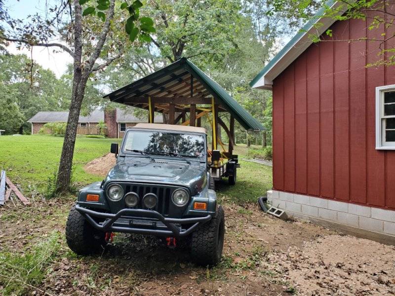

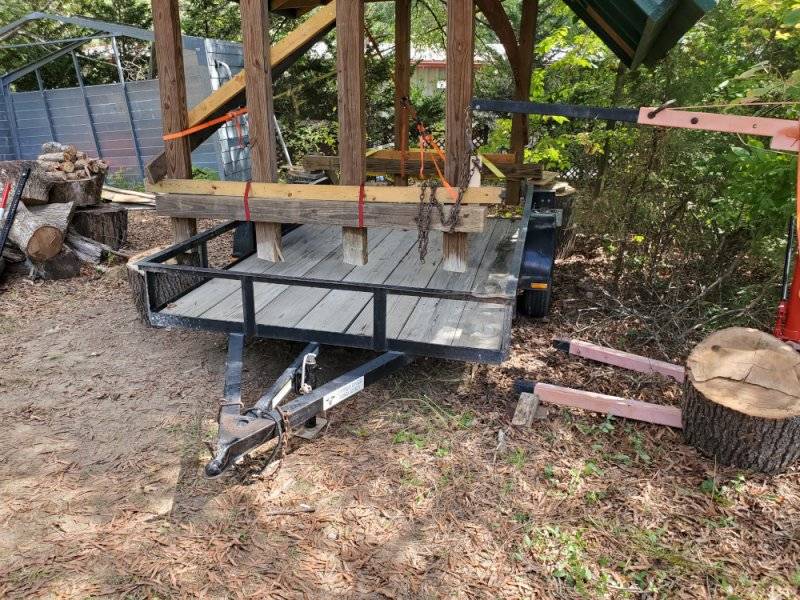

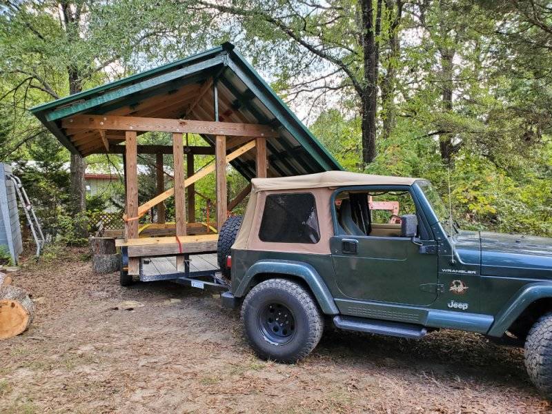

Here's all the disassembled parts - in the moved shop - awaiting the building to be moved and rebuilt . . .
Seems like I'm moving a whole lot of stuff . . . too bad I didn't get it in a good place in the first place . . .
Live . . . and learn . . .

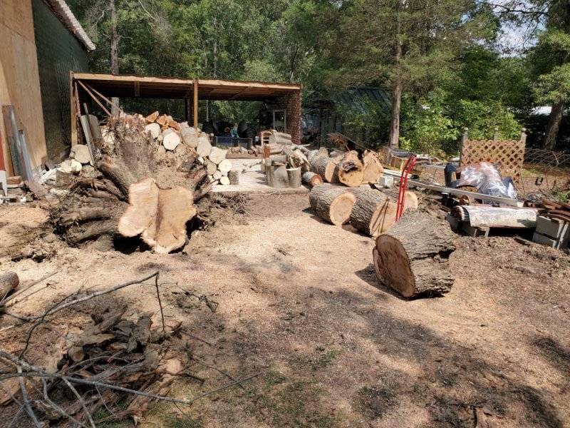

Cleanup, or should I saw cutting is coming to an end as most of the stuff has now been cut up . . .
awaiting the moving of the building, so it can all be moved and restacked to help it dry . . .

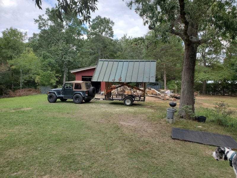

Hoping to make some progress on the firewood building move this weekend . . . it's holding me up !

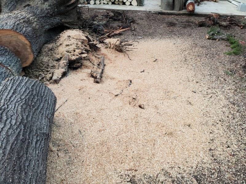

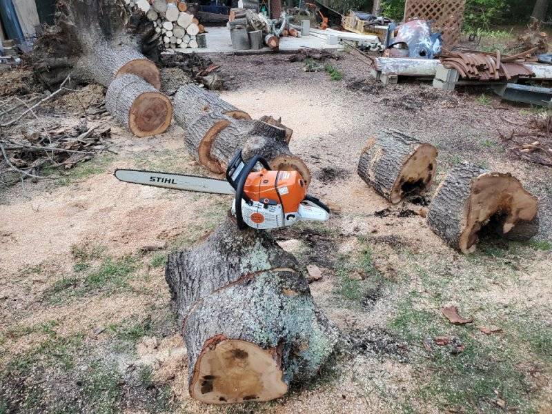

Which Stihl model did you get?Looks like it snowed at my house . . . what do you think ? ? ? ?
Finally broke down and got myself a new commercial grade chainsaw to help with the cutting.
And the verdict is in . . .
Holy Qwap ! ! !
This saw is a "beast" . . . and it made this huge oak tree a simple task . . .
Look at the chips that this thing threw out . . . and bog down . . . No way ! ! !
Went pretty big but it is well deserved and it'll really help with cutting part of firewood . . . for sure.
More Later . . .
Which Stihl Chainsaw model was purchased . . .Which Stihl model did you get?
At 92cc it better make light work out of just about anything, now where's the 36" bar so you can cut 2 at once?Looks like it snowed at my house . . . what do you think ? ? ? ?
