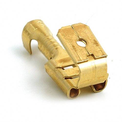

3rd gens got a fused ACC provision on harness, and also couple of spade terminals embossed into tHe fuse box, one from BATT buss bar and another for ACC buss bar, non fused, but earliers just get terminals straight at fuse box bar provisions. When requiring more will need to use splitting terminals to be inserted in a same row.
Either something like this:

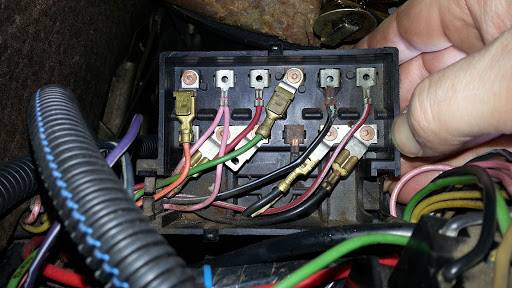

Or what MaMopar made on acc harness pigtails for stack on accesories sources straight to the buss bar provisions, using these piggy back terminals.
Some of them visible here
M0RXKCfkT6ps5pDdCM9k4_DE5xaZarVhA9t0Jf6d7FVQ9Ou2Q-JDKdhX4GDt7gqJyIRhQWXdVxssxzN89kuKXRhX_PfnCp1o.jpg
FYI, buss bar with red wire is BATT and Black wire is ACC
