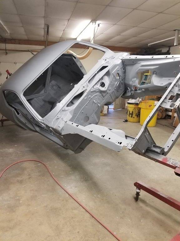

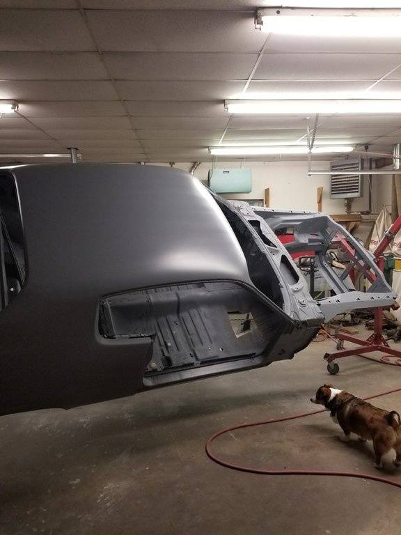

Mission accomplished ! After rust mort, pressure washing, spot sandblasting, DA sanding forever, gallon of wax and grease remover I was ready to spray 2 coats of epoxy. that's after having the car blasted and sanding it to bare metal. Lesson learned... never prep a car in 95 percent humidity. If I had waited 24 hours the humidity dropped to 59 percent! cost me hours of work. but its done for now thanks again for the input.
Looks good. Amazing how much work is still left after media blasting.
