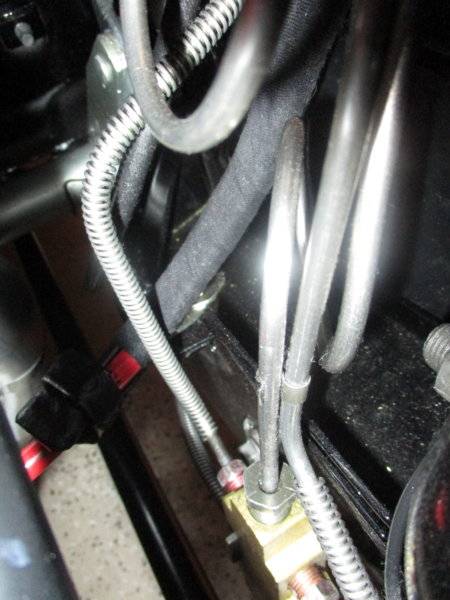

Quality control check !! Did you remember this S clip??
These are the eyes and ears I like! I welcome it with open arms....
That "s" clip is in place but was placed on later.....I clearly remember because snapping that thing in at the time one edge sliced my finger.....It is so small and thin....
I don't recall even showing a pic nor explain once installed....Gives me something to add to the thread and I will try to get a clear picture of it tomorrow!

Are you talking about the clip for the 2 brake lines Justin?

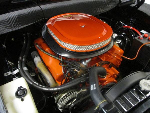

Restoring/refinishing the exhaust manifolds on these cars has always been a dilemma for me. I've thought about the treatment you gave the manifolds on your GTX: Ceramic coating followed by engine paint over parts of the manifold.
I'm wondering how the finish held up and how it looks after the engine has been run a while. I can't even decide what they DID look like on these cars after the owners drove them home from the dealership. Would you happen to have any post fire-up photos or could you kindly describe how they look now?

I have tried many many things on the exhaust manifolds...Each one with mixed results....The current ceramic coating is holding up well and has a more "original look" appearance. They also are coated internally all the way through....The key mistake people do is putting them on a motor and then breaking the motor in....The issue is timing is not set and one can create high than normal temperature and it will destroy the ceramic coating....
My motor was dyno tuned and then got further break in and tuning on a engine run stand prior to paint and assembly of the manifolds. Even once the motor was detailed and installed there is a process to properly "break in" the ceramic coat...They send directions with the manifolds on how to do this....
From this point we shall see how it holds up...so far so good...
They factory was a bare cast finish...They also did not use gaskets either btw....I stewed over doing the bare cast but once they rust thats it....I have heard people coating them with anti-seize to retain the original look....There are just some areas on these restorations I just don't gamble with....Bare manifolds, no manifold gaskets and natural fuel/brake lines....They can ding me all day long in those areas.......
