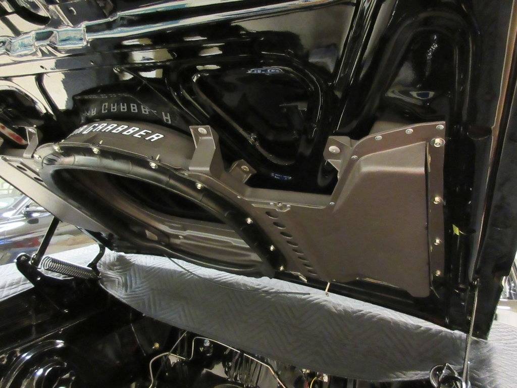

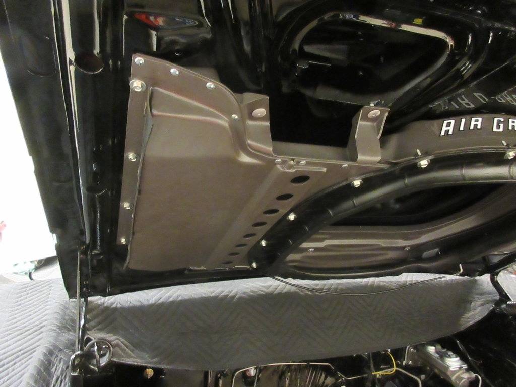

Earlier in this thread I post pics of my air grabber unit and began the installation. During the install of the first piece which is the center piece it unfortunately cracked in one area. I sent it back to Air Grabber Restorations, Don Hall, and he said it was more than likely a hairline crack that presented itself during installation. These 40 plus year old units can be restored completely and during shipment they can develop cracks form being thrown around etc.. Which is why they are packed heavily but it happens unfortunately.
In the end the repaired unit and the rest of the air grabber unit installed perfectly. Center piece goes on first and then either side box next and so on. Original cable and NOS actuator cable under dash was installed and the doors function perfectly.

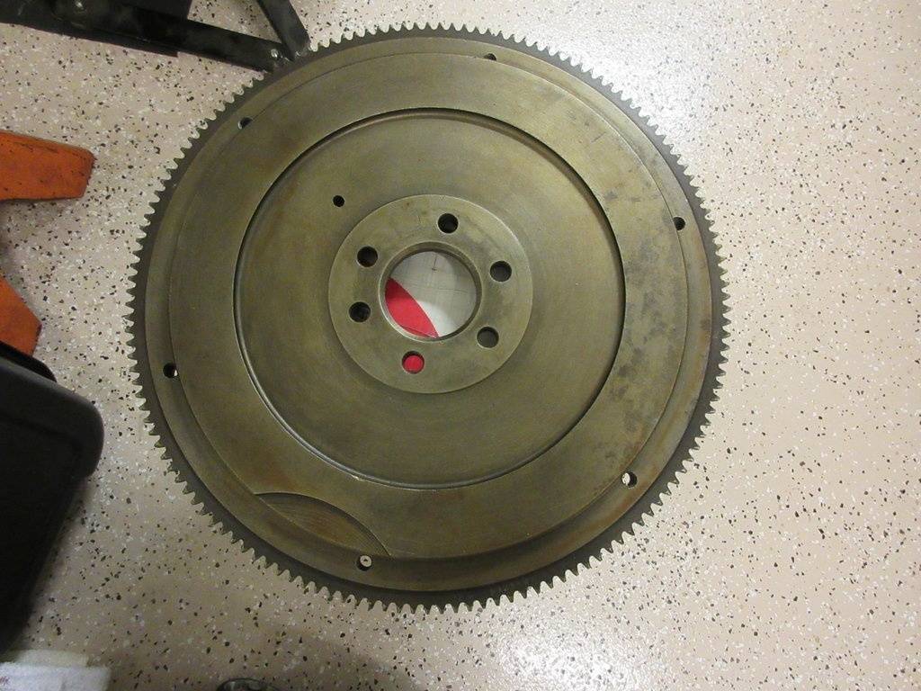

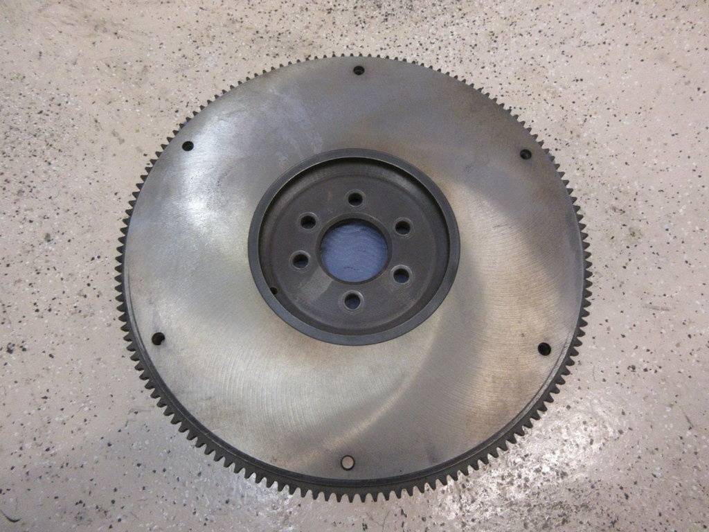

Flywheel was surfaced and cleaned up. The crank side I coated with cosmoline and the clutch surface I used a rust preventer which will be cleaned off during install. This unit is an older aftermarket piece and it was in the car prior to disassembly. I have heard horror stories about NOS flywheels and I know where some are but I just will not risk it. The same goes for the clutch disc, pressure plate, and throw out bearing. I want to put it together once and eliminate headaches plus I can sleep better at night knowing this....

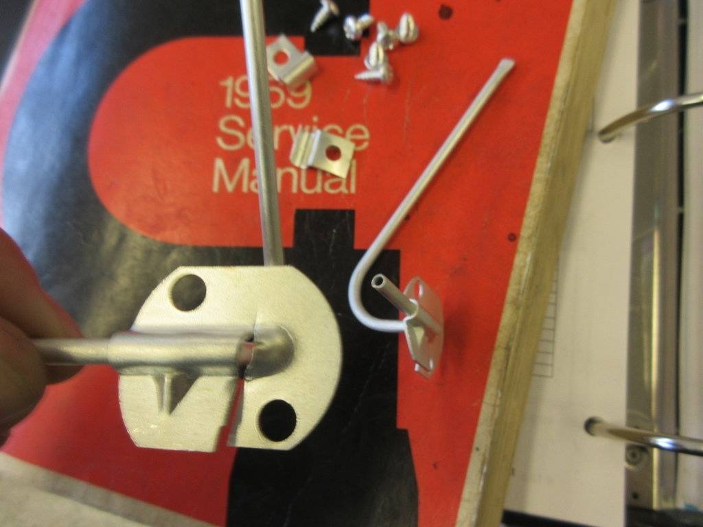

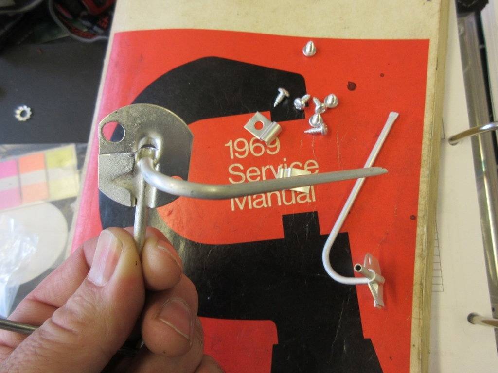

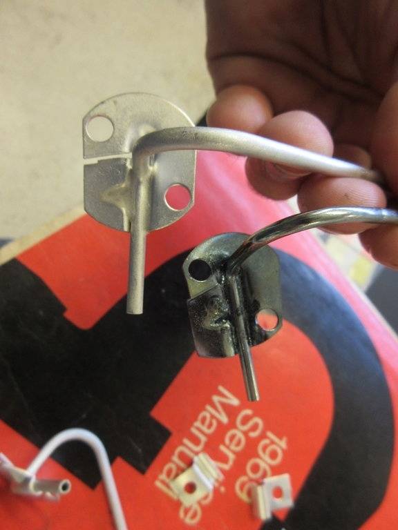

I sent my original washer sprayers out to be plated. Below is a comparison of the original to the new ones(shiny). They are not even close to the originals. The hardware and hold down clips(on the right) are not even close to the originals as well. The correct ribbed hose came from Frank Badalson.

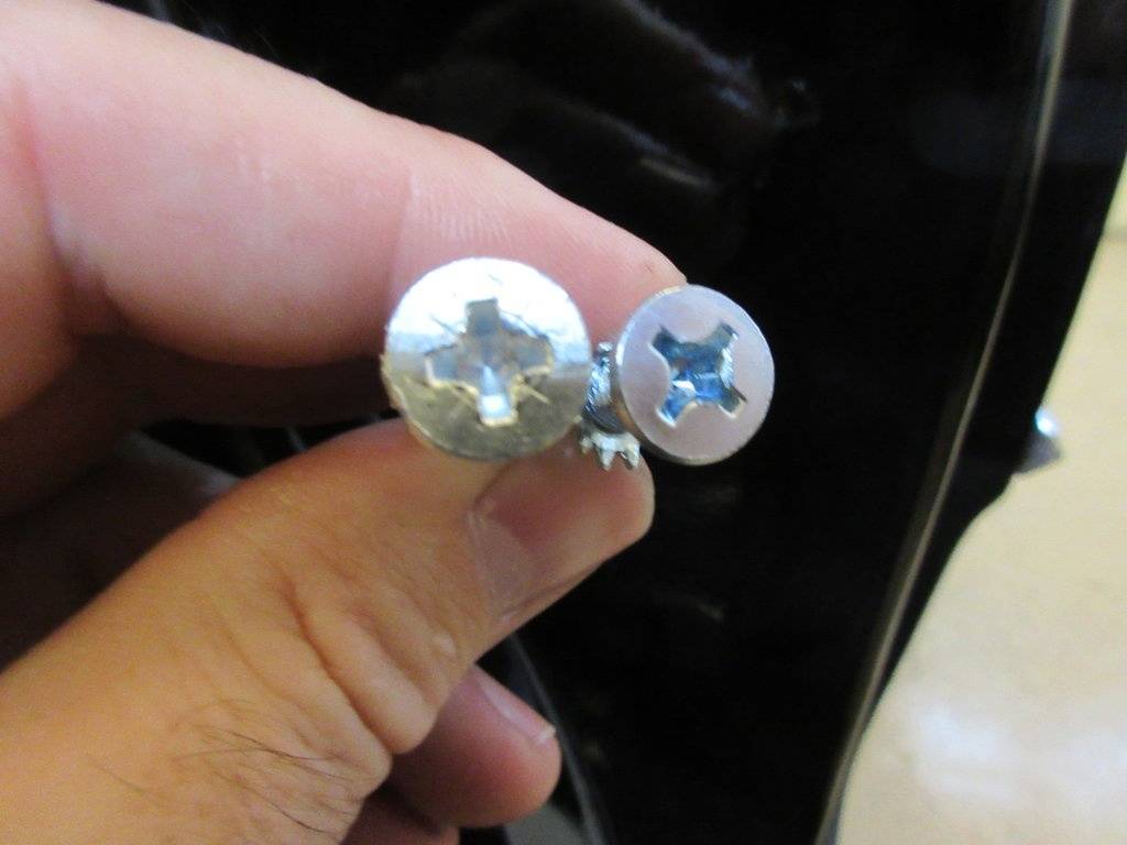

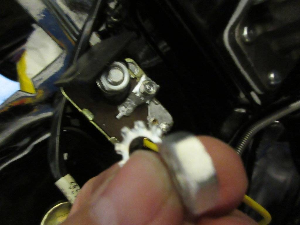

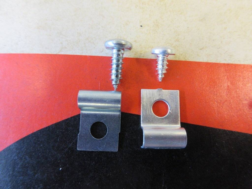

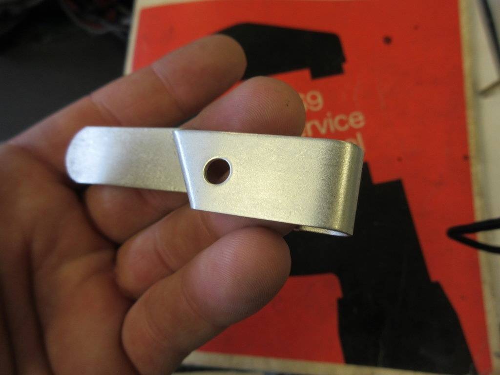

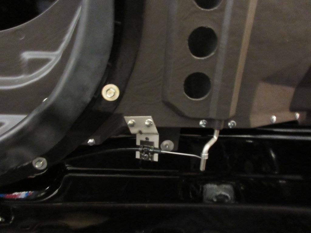

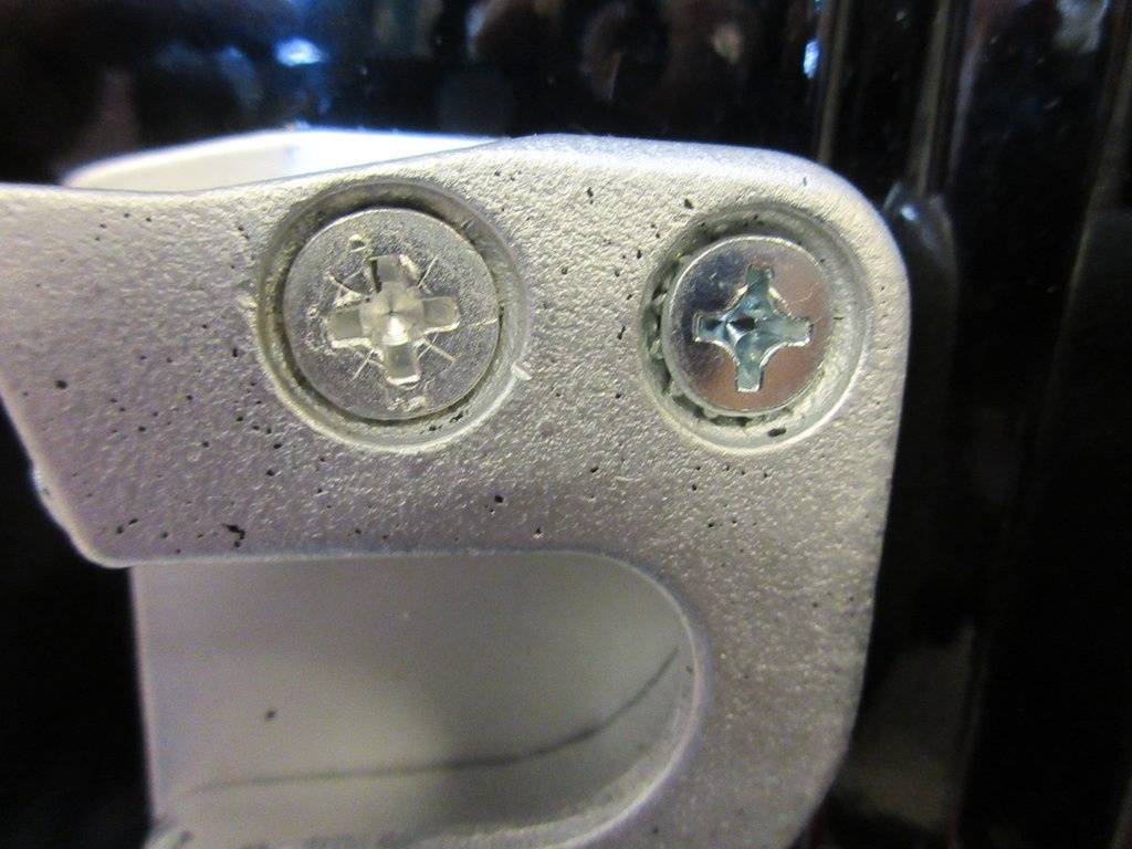

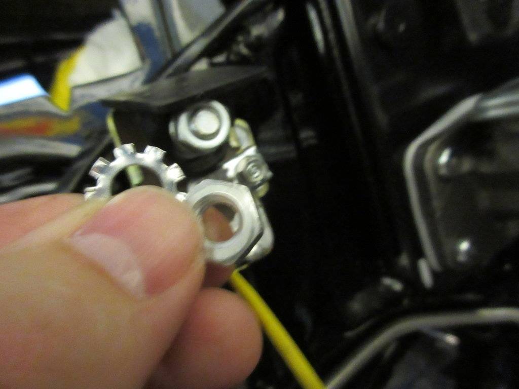

First two pics show the correct nut and lock washer for the starter relay I got back from plating. The next 3 pics show the original speedo cable/brake bracket that got on the driver inner fender. The next 3 pics I show a comparison between the original striker bolt versus the new (shiny) bolts....a big difference.....

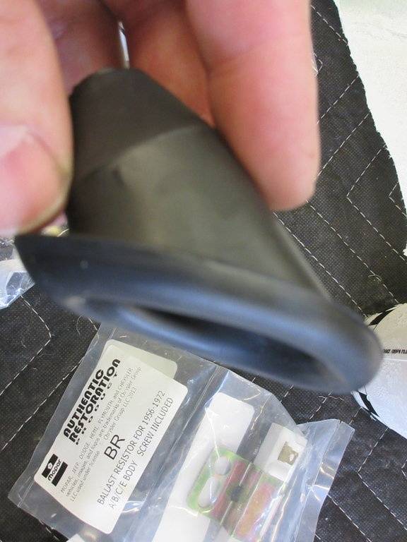

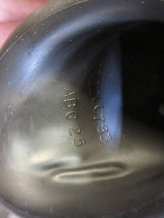

Last two pics is a new clutch fork rod boot and it has the correct part number and DPCD logo....one of the few repop items thats correct.

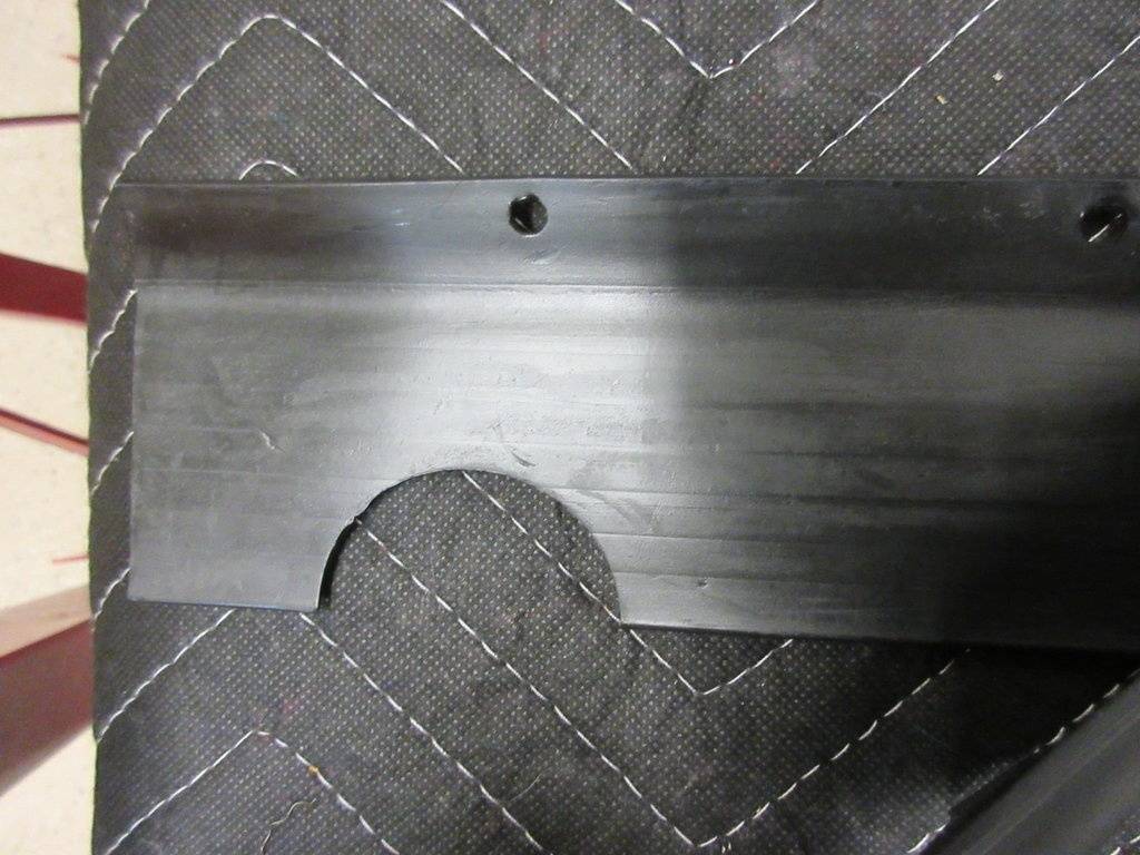

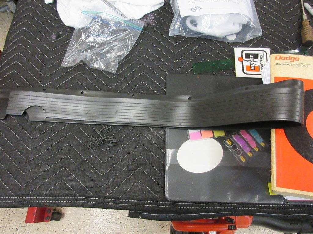

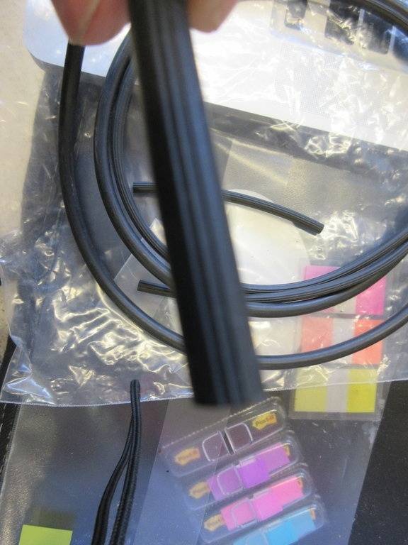

Original front rad support hood seal. Original clips where phosphate plated and the seal was cleaned up..
