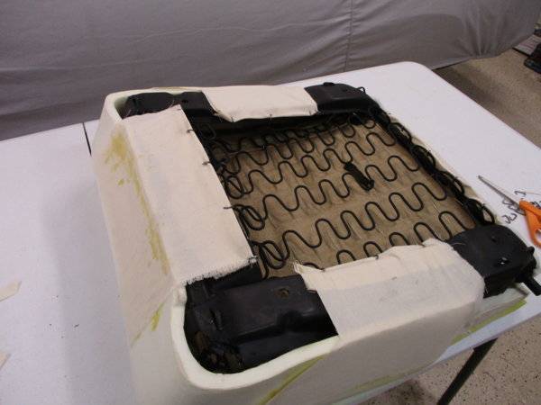

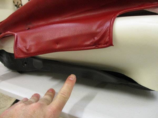

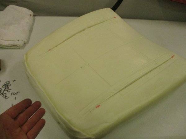

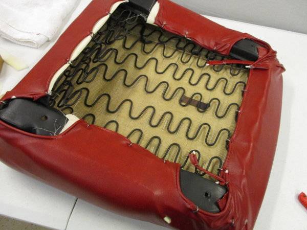

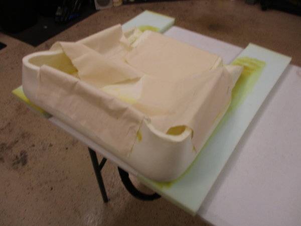

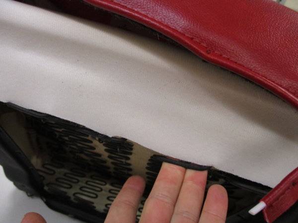

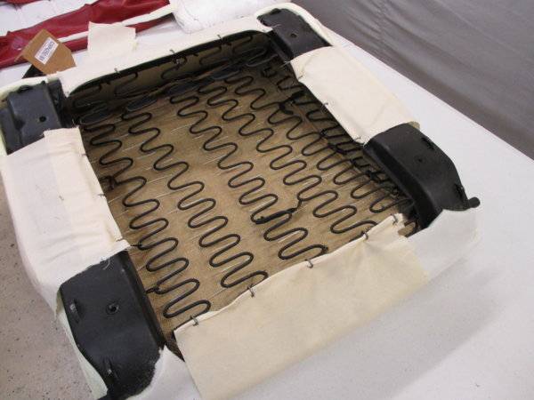

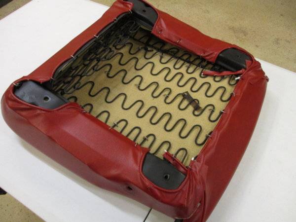

Even though this is the first bucket seat done. I will say they are way easier to do than the rear seat. The front seats were the worst due to the wrinkles on the bolsters and the horizontal ribs were off.

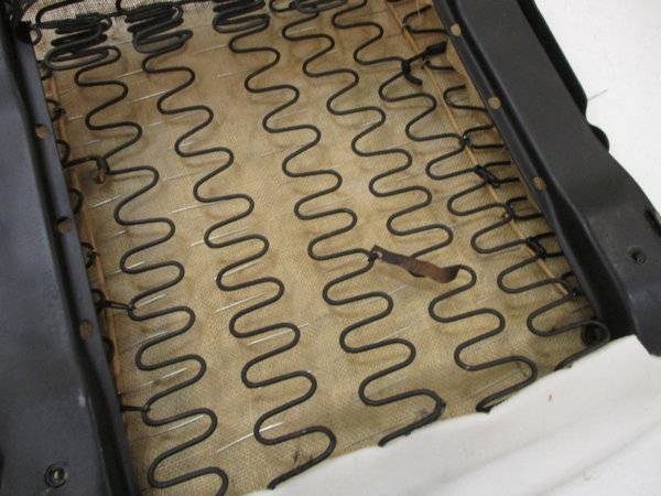

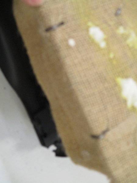

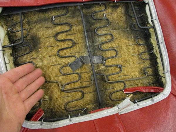

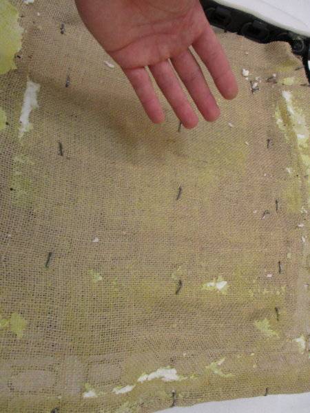

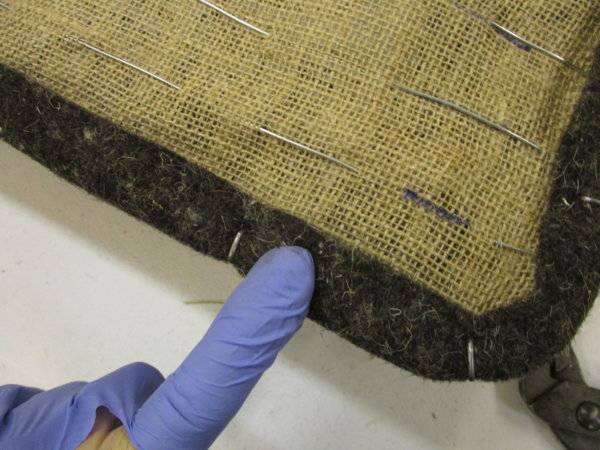

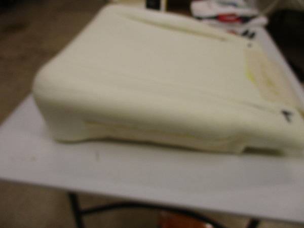

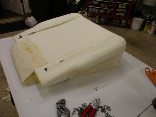

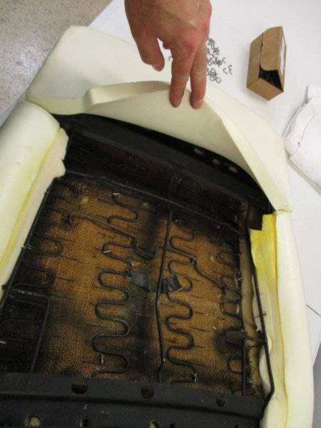

So many mistakes the previous installer did I am not sure where to begin. On the seat bottoms the sides they did not attack the muslin which wraps around the frame and keeps the side cushions in place so the do not kick inside the frame. The burlap was installed incorrectly and the foam was not added to the upper side bolster area. Around the upper frame perimeter they did not add the material to protect the molded seat foam from the frame to wear through.

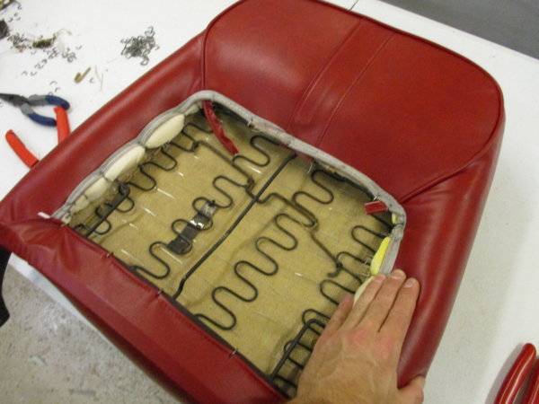

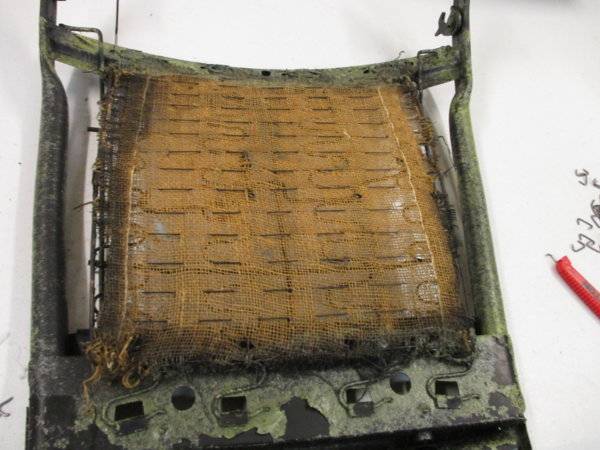

##These are the Disassembly pics##

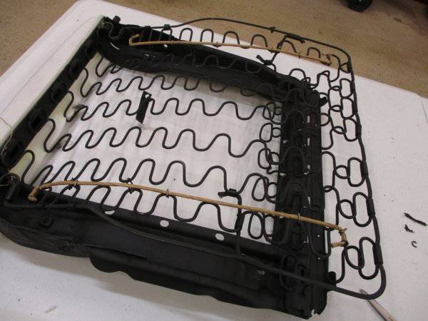

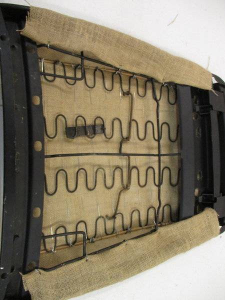

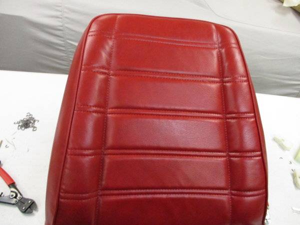

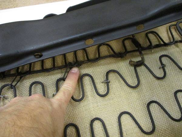

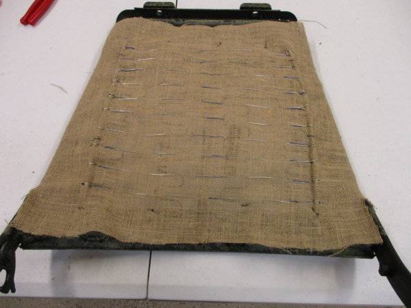

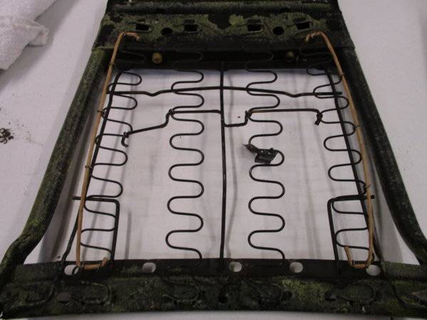

So now to the upper seat back. They left the old worn out smelly burlap with wire and mounted new burlap on top of...Just last by not replacing the listing wire as the seat bottom. The backside moulded foam was not hog tied to the frame. Also, the headrest areas were not cut out of the foam....Additional foam was not added to the side bolsters to prevent wrinkles...
When I do the driver seat I will have more pictures of the install....
##disassembly pics##

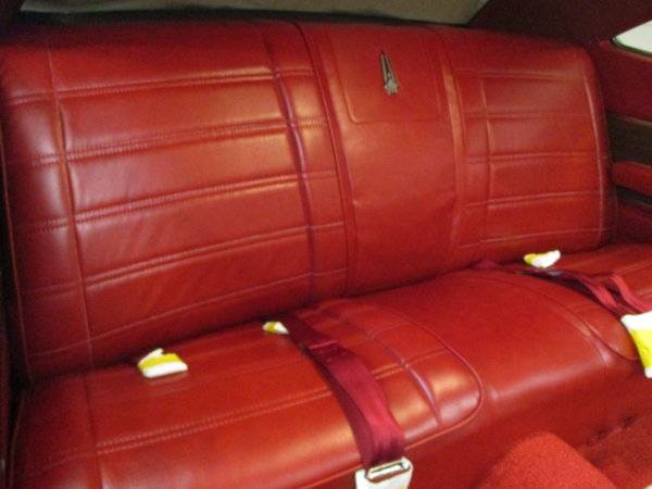

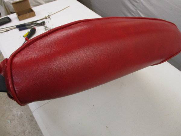

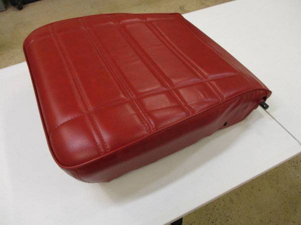

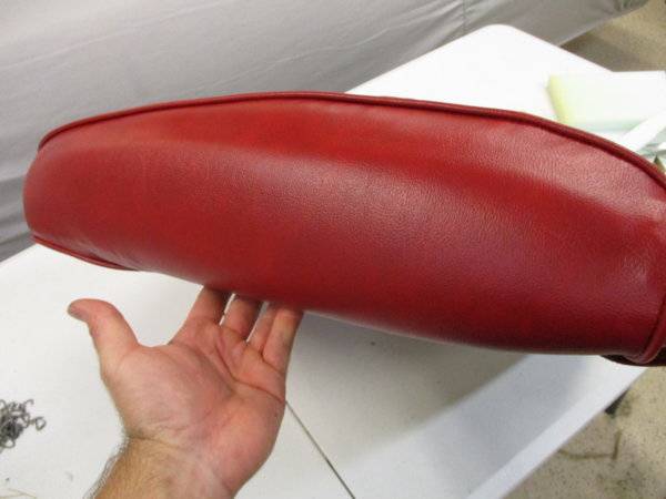

Passenger seat DONE! Will be finished up and out in the car tomorrow evening...
