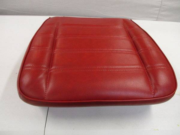

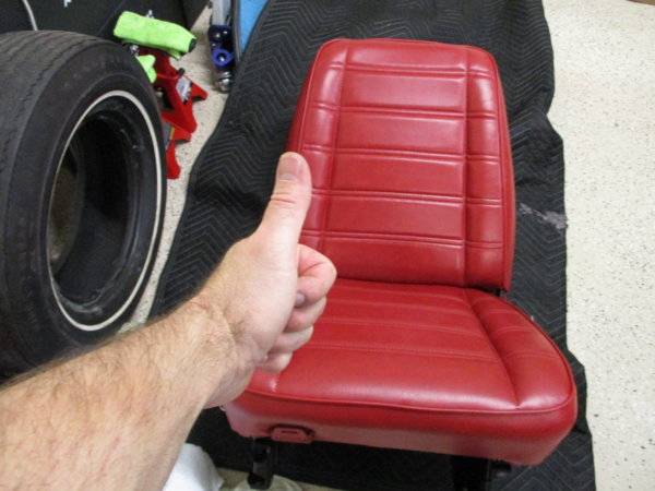

DONE! My right hand is jacked up...lol....Good thing I am a switch hitter:lol:
##In the first pic the Goodyear Speedway Pro tire is the original tire that came on the GTX it was on the spare tire rim##

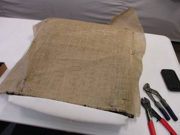

Based on the skills I have seen in your thread. I have no doubt with the Legendary video and some patience you can accomplish this as well. Just know that sometimes once you set a hog ring you may have to go back and remove some and reposition/stretch ect. If is not a one and done clamping process but typically you just reuse the hole already made.

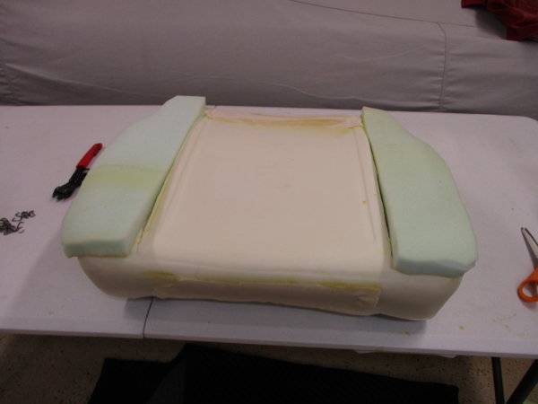

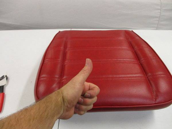

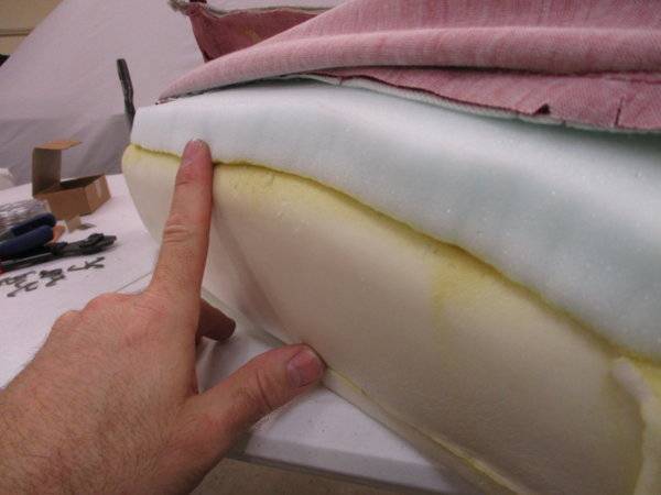

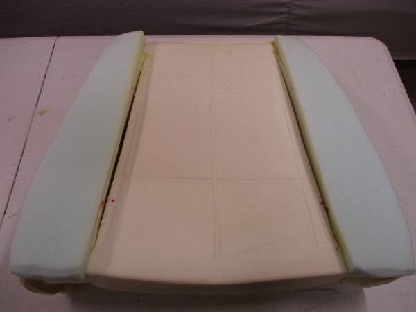

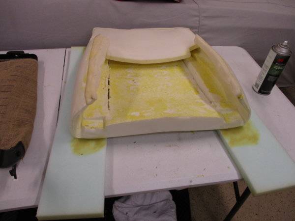

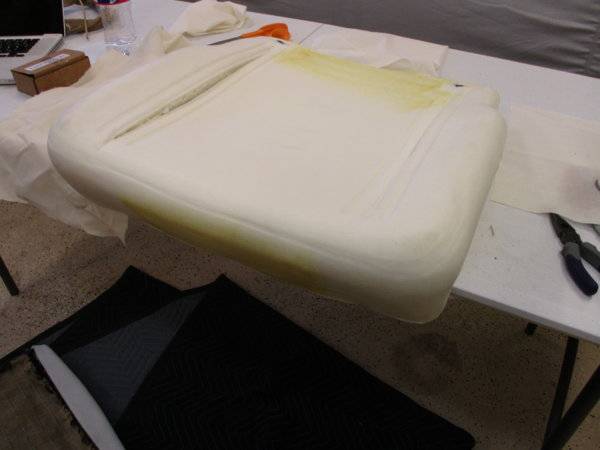

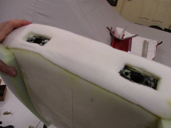

Justin, seats look awesome! I have done a few sets myself, and I must say your hands will be sore for a few days. The cost savings is well worth it. Not to mention you know as well as I do that the quality of most peoples work will just disappoint ya anyways. Question for ya regarding the seat foam. I have a 68 Charger and am looking at the buckets where you added the foam on the outer sides to keep the bolstering and wrinkles down. I don't think I want to do that with mine because my covers are pronounced on the outers like your GTX is. Your buckets turned out awesome looking by the way after that foam addition! Did you get the foam/seat buns from legendary as well?
When all is said and done with what I had to purchased additionally and money recouped back I still lost about 500 bucks roughly......So there was all loss and zero savings but at least they are right! Guess in the end it was a $500 training class on doing seats. So not a total loss....
The foam added to the molded foam is only for Plymouth seat covers because of the side boaters and 2 listing wires on the covers. Charger has a one piece 1/2 foam added on top of the moulded foam and the cover has a single listing down the center. Charger covers are meant to be flat versus Plymouth.
Everything for my seats was from Legendary.....

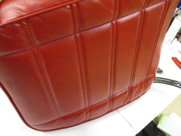

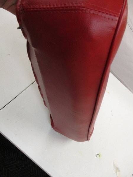

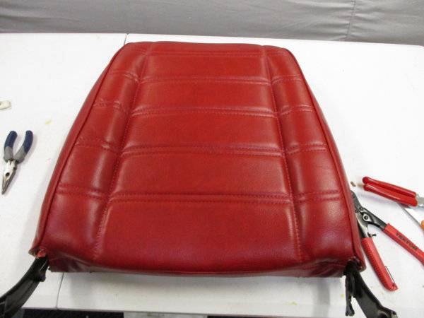

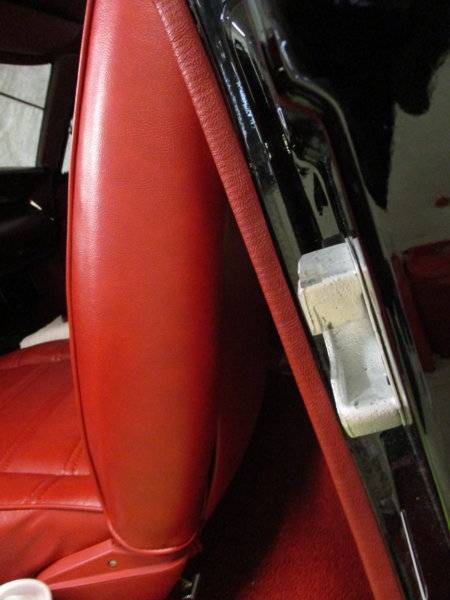

LOOK AT THOSE FLIPPING WRINKLES IN PIC 2
Yeah, Ray Charles could have done a better job!
Hey, they're done right now. Good thing they were stitched ok. I've seen examples where the pieces didn't line up, back seat, one side different than the other, ect. School of hard knocks and you are that much wiser for it. Nice work!
Thanks Kidd....
This errors you mention above in the covers was in the rear upper seat back. So Legendary made another one rather quickly. When you receive this stuff of course you inspect everything but some things are not noticeable until you install them unfortunately...Keeping things lined up was a test/retest on the front buckets. They say line up the bottom edge and attach the listings but if I did it in the manner the horizontal lines would be off. So the cut on the bottom edge was off. That is where the test and retest came into play....
